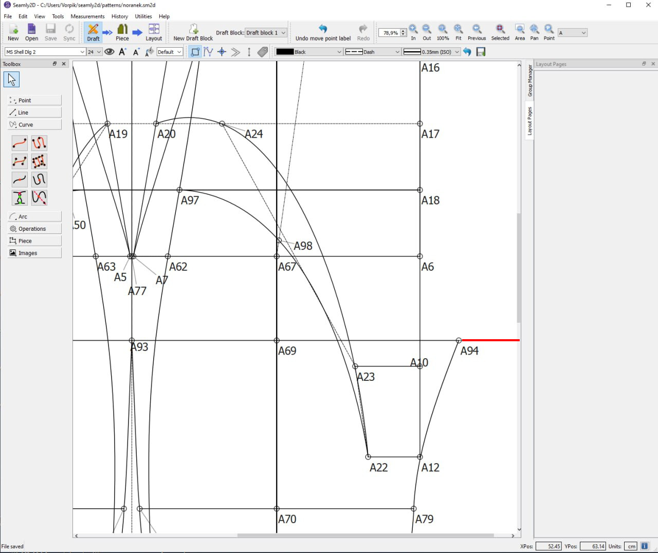

How can I draw a curve of a specific length, same as another curve? This curve should be the same length as the curve from A22 to A98. Point A of this curve should be at point A98 and the end point at the extension of the line that I marked in red (after point A94)

You can’t… other than by trial and error. Changing any control point length or angle will change the length of the curve… and there is an infinite number of combinations that will result in the same curve length.
I would first mirror the existing curve and then use the Move tool to move and rotate the mirrored curve into position. This will need a few extra points and lines added to use for the angles and rotations and it may be a little finicky to get it right at first when you use it.
If you struggle, send me your pattern & I’ll do it for you.
