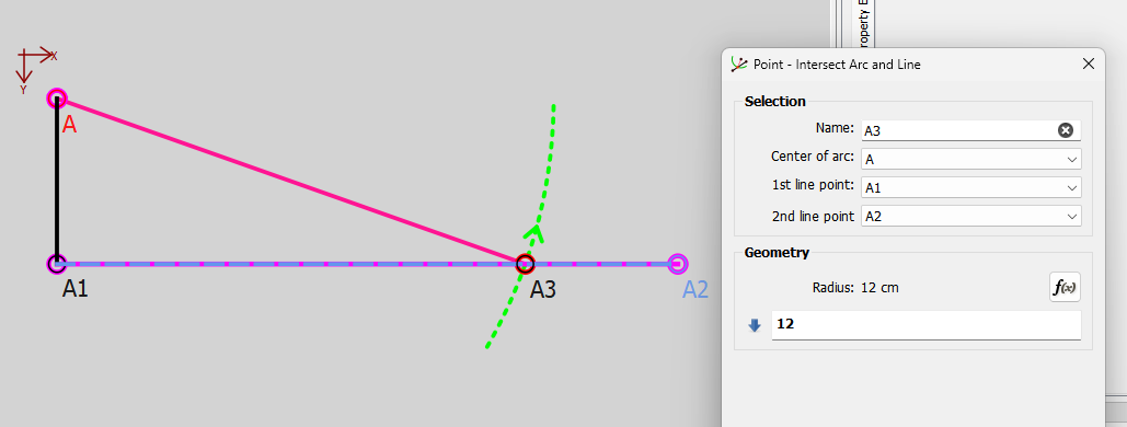

I think this is what you are trying to do.
Line_A_A1 is 4cm at 270 degs.
Line_A1_A2 is an arbritrary length > 12 cm at 0 degs (blue dash).
Using the Point - Intersect Arc and Line tool
Point A3: The line is Line_A1_A2, the center point
of the arc is A, and the radius is 12 cm.
Using the Line tool I added the Line_A_A3 (pink solid)
For clarity I added the dotted green arc with a radius of 12 cm as the Intersect Arc and LIne tool does not (currently) display the arc.

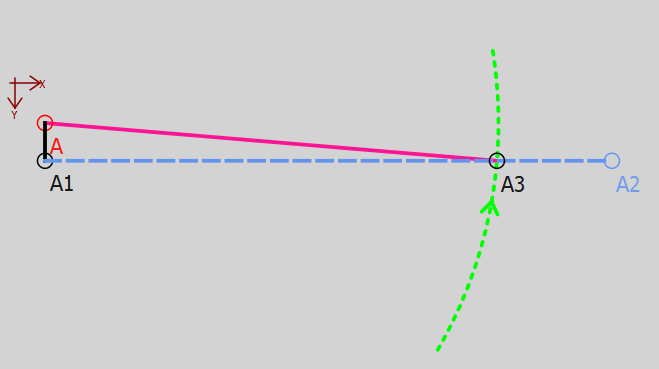

Any change in the length of Line_A_A1 wil still produce a 12 cm lenght of Line_A_A3:
Thanks! That was a great description! Douglas’s answer just above should be exactly what you were looking for.
There’s also the “shoulder” tool, but that has a quirk if not used correctly so I suggested the Intersect Arc and Line.
It worked! Thank you very much, it was very easy to understand :grin:
