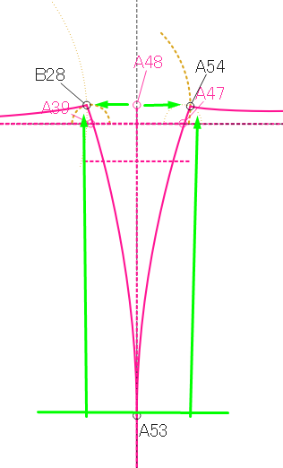

The 2 side curves actually form a 5th dart, so you can actually just mirror the one curve to make it identical to the other. If they’re not, the skirt won’t hang nicely or fit over the side of the body, creating drag lines and folds.
Your problem is that you need to distribute the excess width in the back between the 2 back darts and make sure that the side curves are indented and curved enough to fit the fabric to the shape of the body when the side seam is sewn together. So whatever you do to the left of point A, you must repeat to the right of point A and vice versa, because these 2 are a pair forming a straight side seam that follows the body in that area.

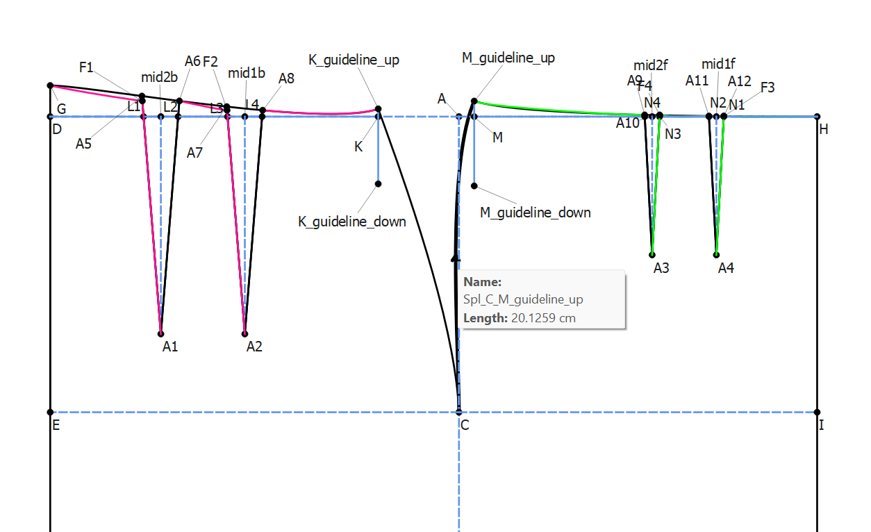

What I do is:
  1. create the Spl_Waistside_Hipside
  2. create a new point at the waist ‘NewWaistSide’ where
    * length = -(Spl_Waistside_to_Hipside - waist_to_hip_side) * angle=(Angle1Spl_waistside_to_hipside - 180)
This NewWaistSide point will be higher than WaistSide if Spl_Waistside_to_Hipside < waist_to_hip_side, and will be lower otherwise.
I create the final curve from NewWaistSide to HipSide.
Can you please tell how to make sure that the curves length from waist side to hip stays the same for front and back if you change the size?

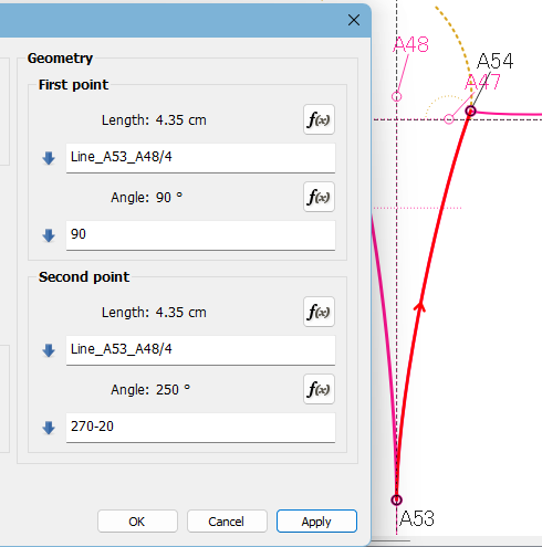

The easiest way is to make sure that the indent of the back and front is the same at the waist line and the rise of the waist is the same:
The height adds extra length to the side seam and width is a dart in the side seam that makes the seam hug the hips and reduces the fabric to partially meet with the waist band. The rest is distributed among the other darts.
The formulas are…
For the length, select the length of the line from the hip line to the waist line divided by 4 on all of the curve handle lengths.
For the angle, the curve handle on the hip line will always go at 90° (straight upwards) for a straight (pencil) skirt, otherwise, it will be the angle of the side seam below the hip line + or - 180°. If the seam below the hip line curves inwards, then use the 90° on the curve above the hip line and 270° on the curve below the hip line.

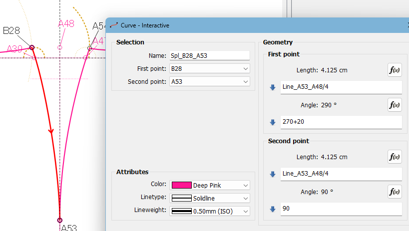

For the waist line curve handle, I find that using 270°+20° = 290° on the left side of the skirt (regardless of whether it is the front or the back) works very well.
Repeat everything on the right side except for the waist curve handle. Here, the angle formula will change to 270° - 20° = 250°.
Once you have the side seams completed, then you can determine the width of the darts and draw in the waist curves using the side seam curve handle angle + or - 90° for the waist-side seam curve handle.
You may check if this resizes nicely :smile:
