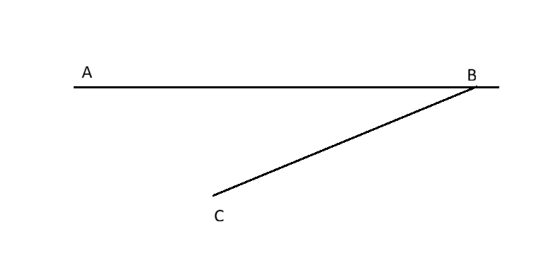

How do I create (see image)
How do I create a point D on the line AB from drawing a line square upwards from C. (So the new line is 90 degrees up on line BC and I need the point where this line crosses AB)

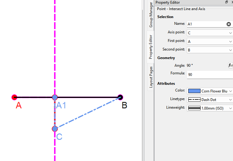

Thanks for your replhy
but this is not what I hoped to ask. The line Needs to be square on BC. NOT on AB.

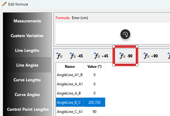

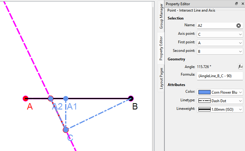

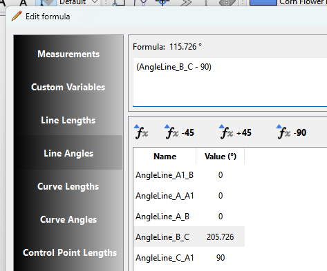

Make the angle formula “line BC -90°”.
Sometimes on a Sunday and my brain in neutral THANK you both

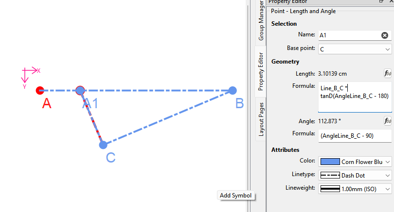

Not sure why I’m awake, should be asleep.. but here’s another solution. Since it’s a right angle and we’re given the angle and adjacent side, we can use the Tan trig function to solve for the length of the opposite side. :thinking:
