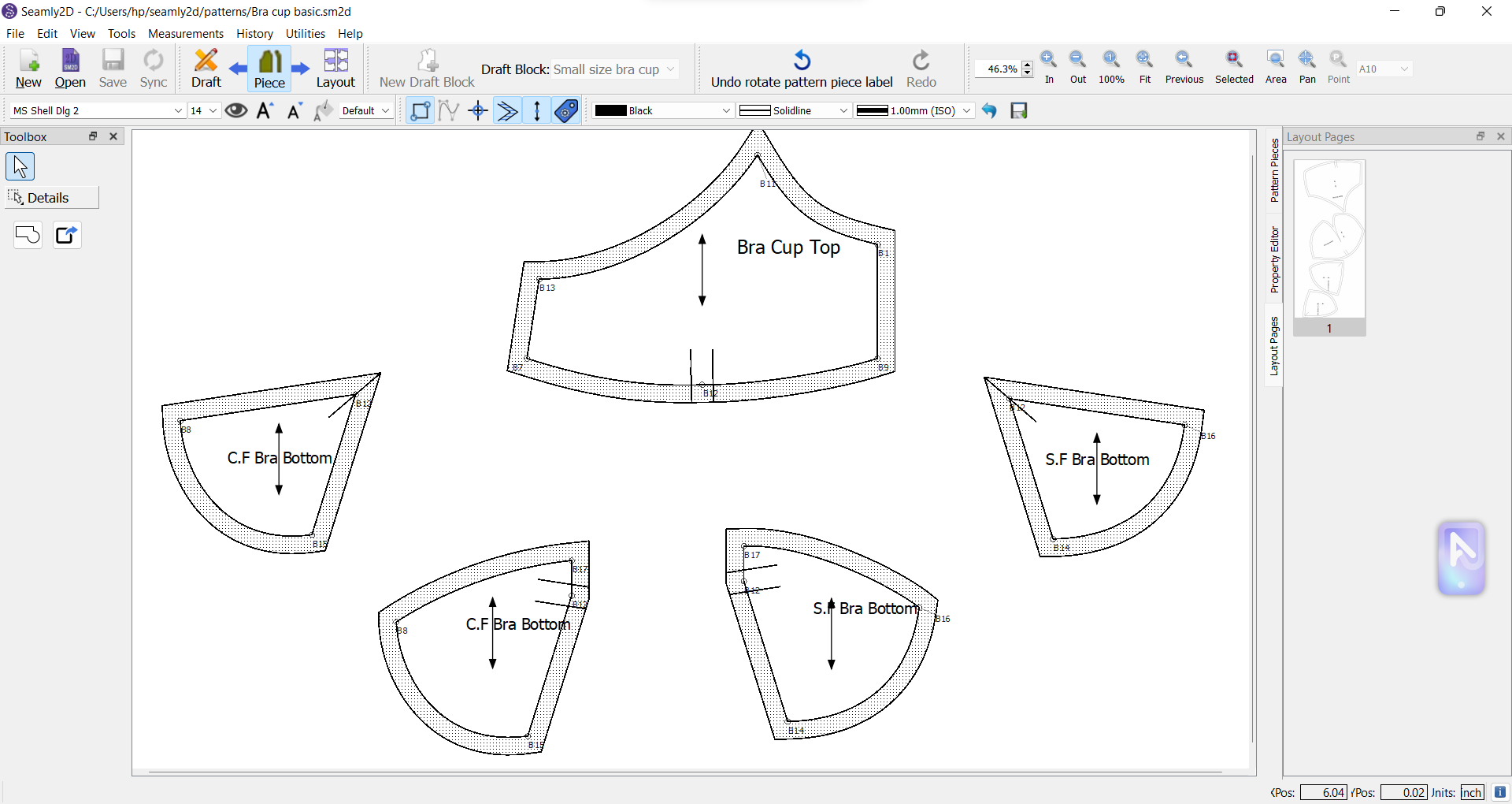

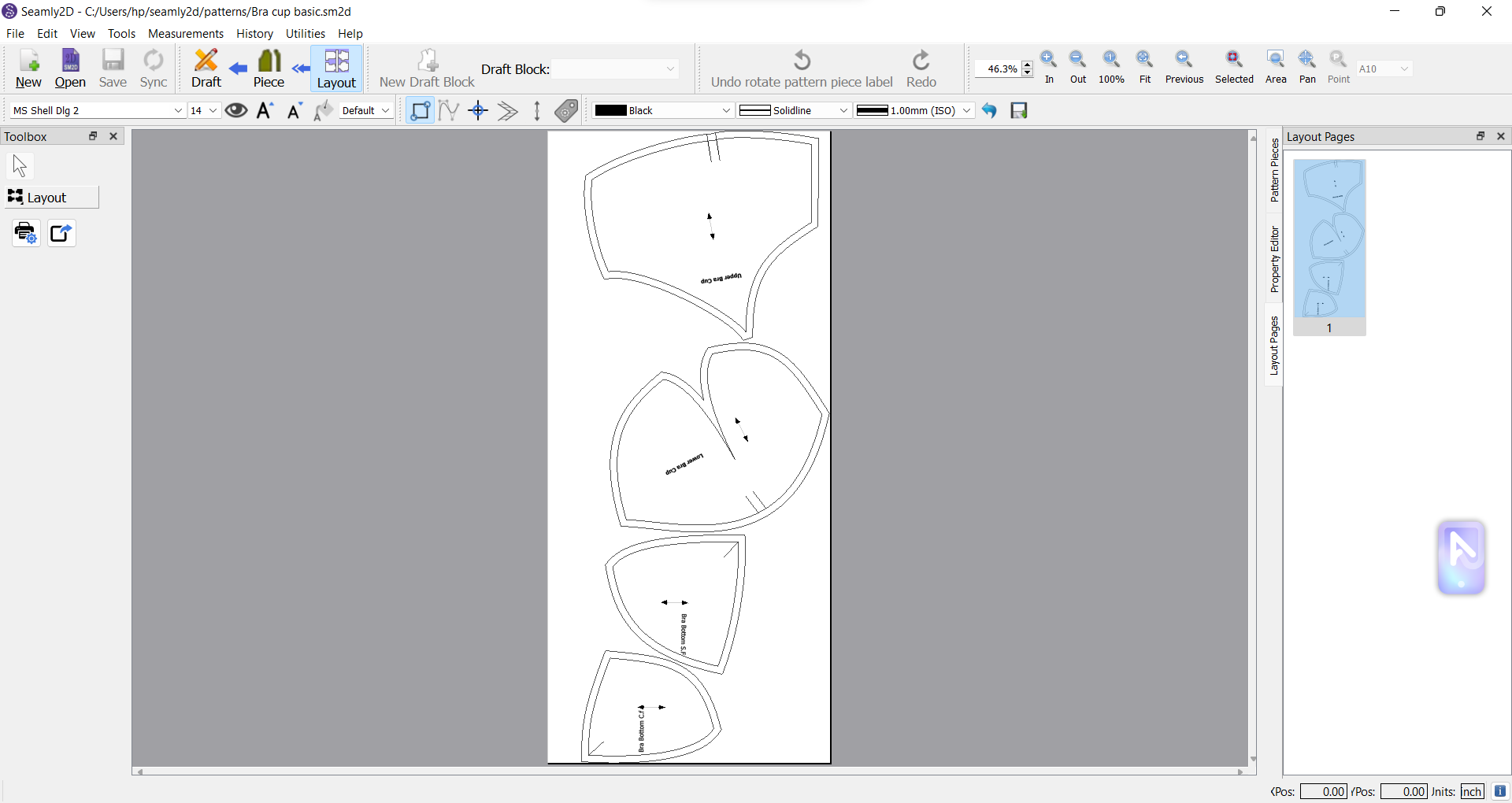

This image shows my current Layout Page, which I’ve already edited and exported using my preferred printing settings.
However, within the same file, I’ve now traced a new pattern piece that I’d like to edit and arrange in the Layout Page. The problem is that the previous pattern is still present in the Layout Page, and I don’t know how to remove or delete it, so I can move and work on the new pattern piece instead.
The second image shows the pattern piece I currently have in Piece Mode.

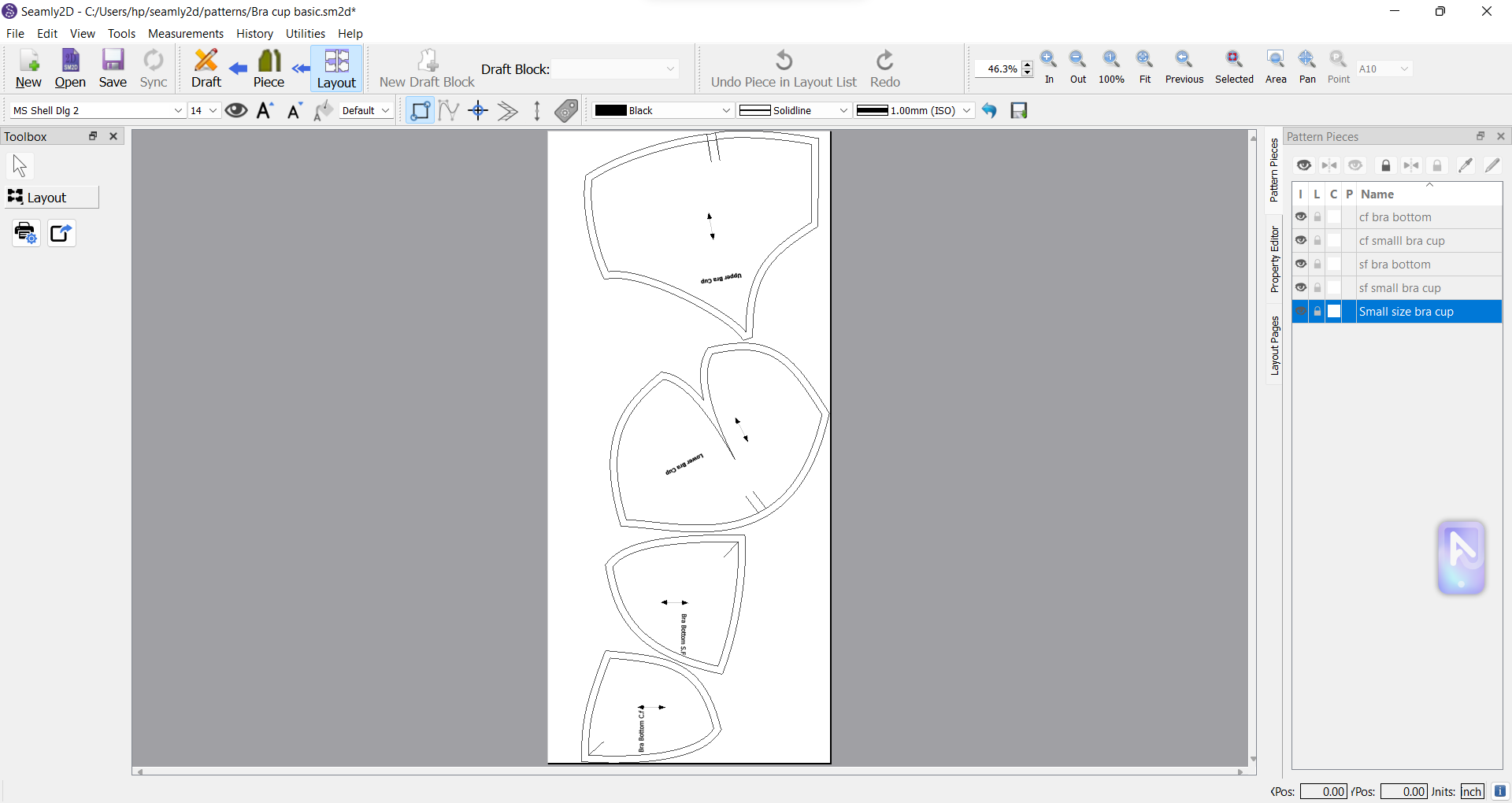

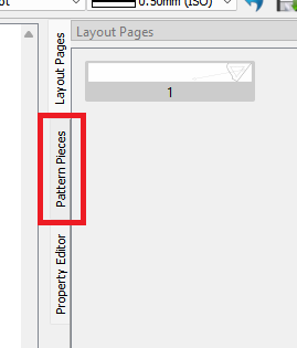

Click the Pattern Pieces tab.
What should i do after i click the pattern piece
