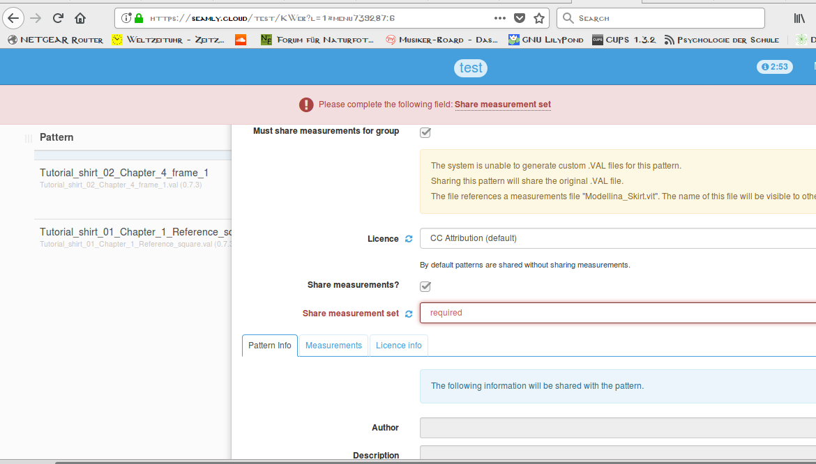

I just tried to share one of the tutorial patterns. I am stuck with “Share measurements”, it is required but it doesn’t give me any options in the pull-down-menu
You first need to ‘customise’ your pattern for one of your individuals (which could be a standard size 12 for instance). This associates the pattern with a set of measurements. The site will then prompt you to complete the necessary measurements if any are missing. Once you have measurements associated with the pattern then they will appear in that drop-down list. (If they don’t then let me know.)

What does that mean? The tutorial pattern uses a .vit-file or a “Modellina Skirt” with some measurements between two sizes; the .vit fie is uploaded. I suppose I might have to do something else?

If you look on the “Individuals” tab you can see some red badges on the association with these patterns. If you click on these it will show you what the missing measurements are and allow you to enter them. Once they are entered then you should be able to pick that individual to associate with the pattern when you share it.
