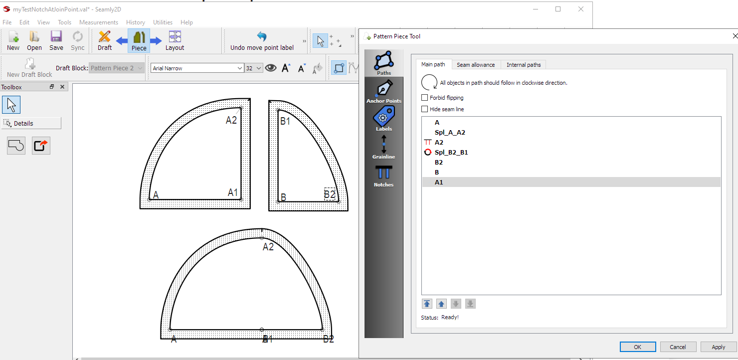

I made a test with two simple draft pieces. Added notches where they would meet. Joined them, and the notch appears automatically. So your pattern has some differences.
Please post your pattern & measurement files so we can troubleshoot.
Thanks! (I’m in Windows with the build from Nov 28)
Well, I made a similar test… discovered some things interesting. I intentionally made the notch type at A2 different for each piece AND lo and behold it added 2 - A2 nodes in the union main path, each with it’s respective notch type. Thing is, if there are 2 nodes with the same name NO notch is displayed. You have to exclude one of them for the notch at that node to show.

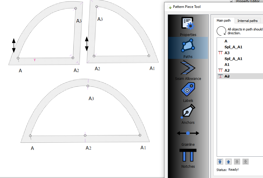

I’ve just been looking into the Union tool and noticed something. In the Options, all the nodes are listed in the order of creation of the piece, so the 2 pieces that are joined, all the nodes are there except the adjoining piece’s 2nd node, and both of the 1st nodes are there (both the 1st piece chosen & the 2nd piece) and these are the 1st and last nodes in the list.
If you choose to place a notch at the 1st node, then it doesn’t show until you Exclude the last node.
image image
I’m wondering why there are 2 x A15 nodes - as the 1st & last - while there is only a node A30 (in other words, only 1 node, since A31 isn’t listed)?
If one can exclude the 2nd node of the 2nd piece, then one should also exclude the 1st node of the 2nd piece. Then there wouldn’t be a question about how to place notches or which notches need to be placed.

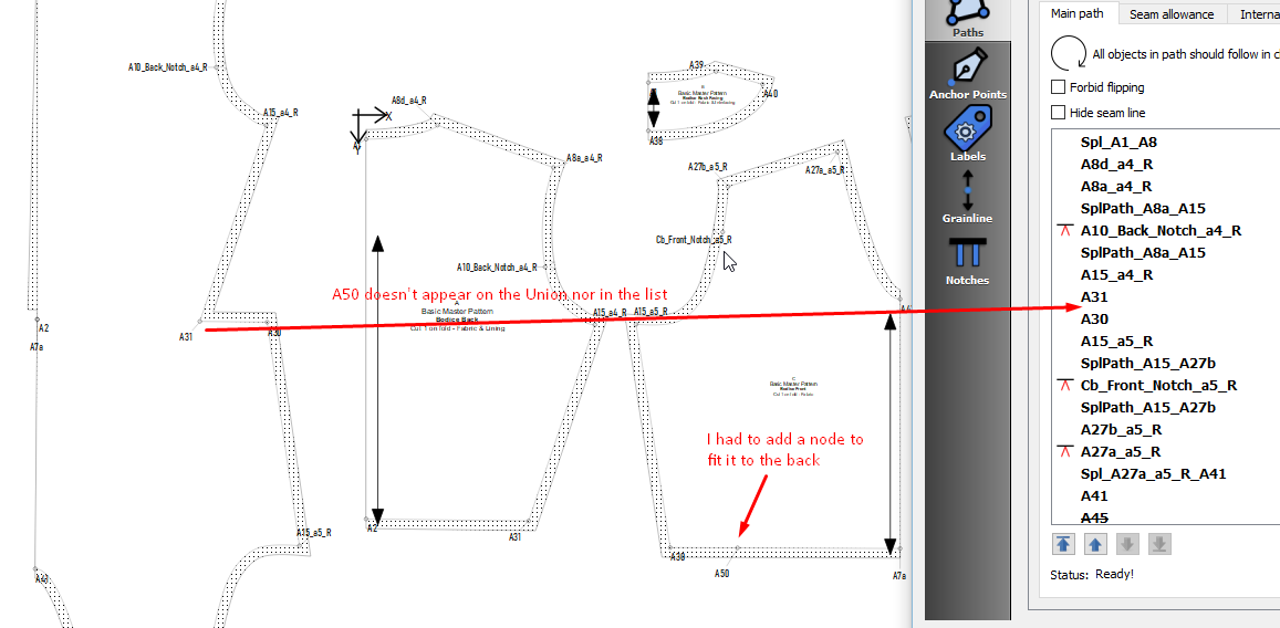

Very strange. I tried joining from the other angle:
The 2nd part of the union, 2nd notch (A50) doesn’t appear in the list nor on the piece.
But both A2 & A7a, which are the 1st nodes of the 2 pieces, appears at the bottom of the list now because of the way the pieces were created & joined:
Now we have 2 nodes on top of each other.
And A2 has no SA after while A7a has no SA before, so the SA of A7a is continued and the A2 is ignored.
