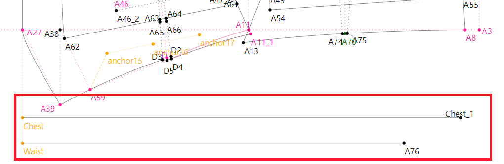

Here’s a pattern from an Annie vest we did. The 2 lines are the aggregate of all the formula lengths that make up the chest and waist.
Hovering over the end points would give me 1/2 the lengths, which I would double and check against the actors mesurements.

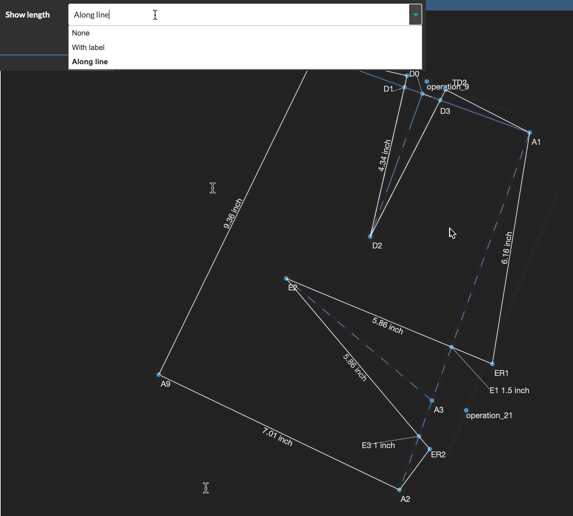

Experimenting in the development version of the cloud environment, I’ve added a show-length option to a drawing object with three options: none; with label; and along line. And here’s how I’m rendering it. My thought is that it would also be useful to have this option on a group, and on an internal path on a piece.

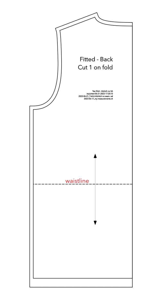

I don’t know if this is the right thread, but I’ve been looking for a way to add a label to a internal path, in piece mode.
For example showing “waistline” next to the dashed line corresponding to the waist level. It’s not a fabric cut but something useful in the exported pdf…
example in red
At the moment, this isn’t possible. I add mine in Inkscape.
No way to do this at this time. Adding symbols and text is on my ToDo list.
