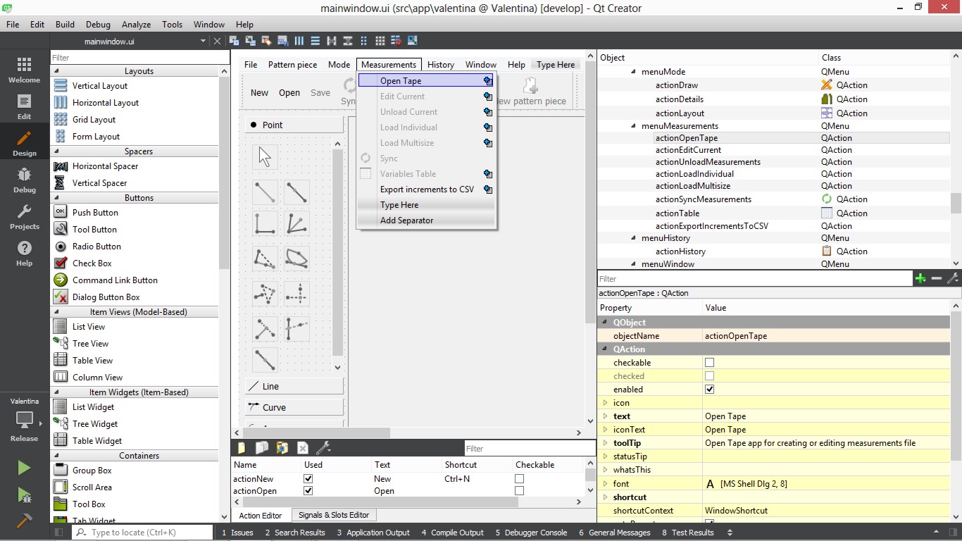

From what I’ve deciphered - the forms are done in Qt Creator which outputs the XML .ui files that get compiled into the windows, menus, drop down boxes , dialogs, etc.
Here’s the familiar main window UI in Creator where you can see the layout for the Measurements menus…
