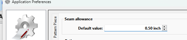

You are correct that you can set a default SA in the prefs:
Which then set’s the default width or ‘CurrentSeamAllowance’ for a new pattern piece. Think of it as the default default SA.

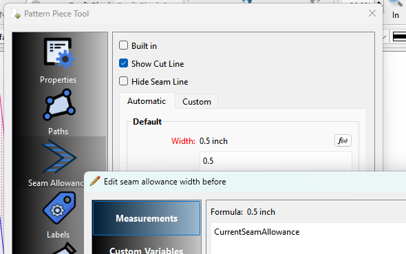

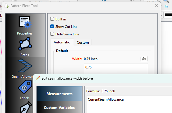

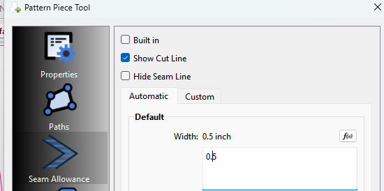

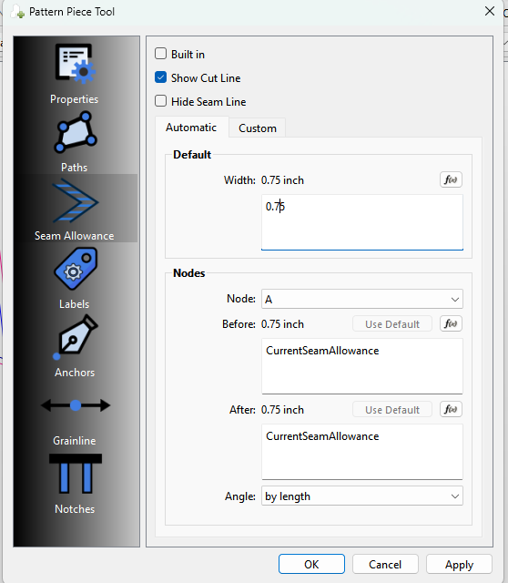

You can edit the default (CurrentSeamAllowance), but it applies only for that piece. In other words the ‘CurrentSeamAllowance’ is local to the piece, and not a global variable. Here I changed the 0.5 to 0.75 and you can see how it updated the Before & After SA’s.
and shows in the fx editor as 0.75:
while another piece is still at 0.5:

Ohhhhh okay for some reason I never saw that big box above the nodes that says default :laughing: I’ve been looking at it for weeks.
That’s good news anyways cause I was thinking if I ever wanted to change it I would have to change it for each individual node :stuck_out_tongue: Much easier to just change one by one of needs be

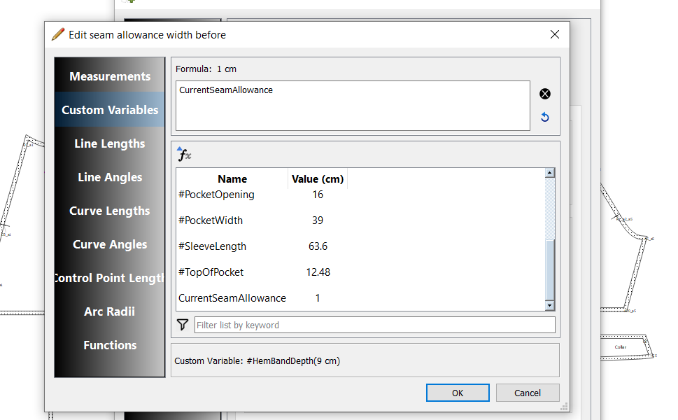

In Custom Variables you can have multiple seam allowances if needed:
  • SA = 5/8
  • NeckSA = 0.5
  • ArmscyeSA = 0.5
  • HemSA = 1.5
Then use #SA, #HemSA, etc. in CurrentSeamAllowance
