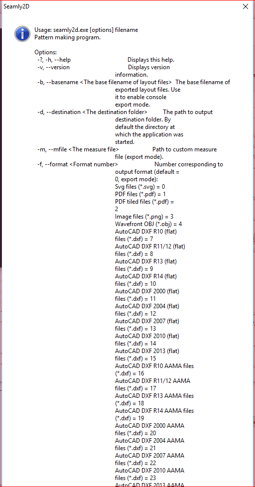

Windows: it displays a popup window which is too long and can’t scroll! So redirect to a text file or go to the wiki.
C:\Program Files (x86)> seamly2d --help
To redirect output to a text file: C:\Program Files (x86)> seamly2d --help > seamly2d_cmd.txt

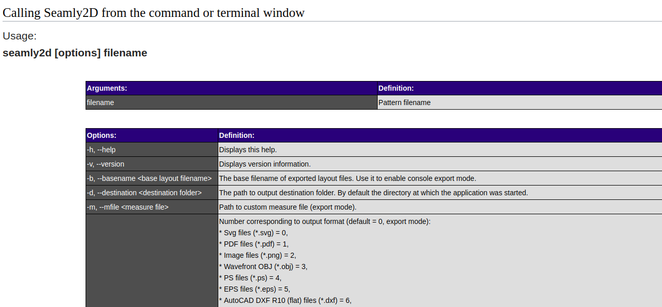

A table with commandline options is now on the wiki:
It looks like this:
