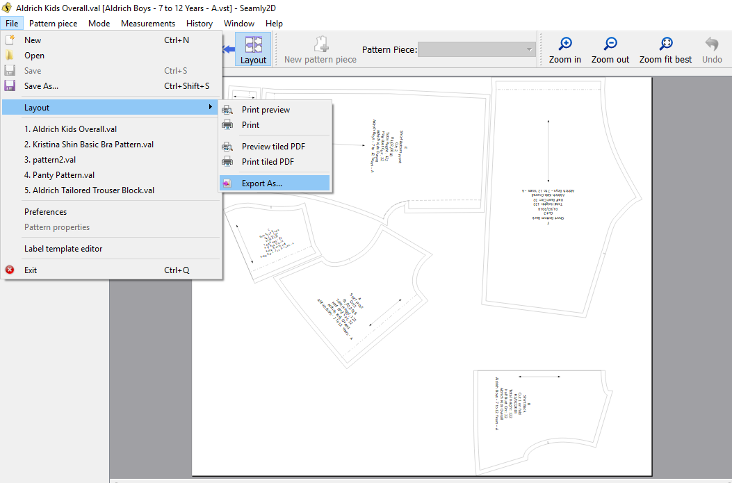

I need to convert my patterns .val for dxf. Becouse i’m use ‘My Nesting’ a free program for optmization a cutting process, but that software just import archive .dxf.

Once you’ve made your pattern and created the layout, using your paper dimensions, you go to File, Layout, Export As and choose the .dxf type that your software works with:
Choose where you’d like to save it and you’re done :smile:
