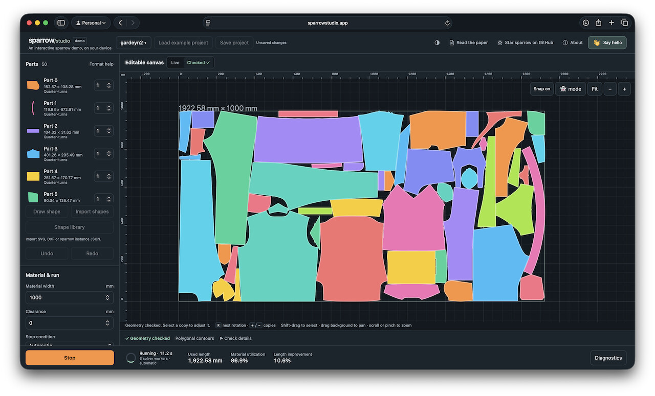

Hi everyone, I’m the developer of sparrow, a state-of-the-art open-source nesting algorithm focused on finding the most compact layouts with very little wasted material.
I’ve built sparrow/studio so anyone can try it in their browser. It arranges irregular pattern pieces across a fixed fabric width, working to reduce the total length needed. You can watch the layout improve as the search runs.
Import SVG or supported DXF outlines, set quantities and permitted rotations, then download the layout. It’s completely free, with no installation or account, and your files stay on your device.
Give it a try—the bundled garment examples are an easy way to see the quality of the layouts it finds.
