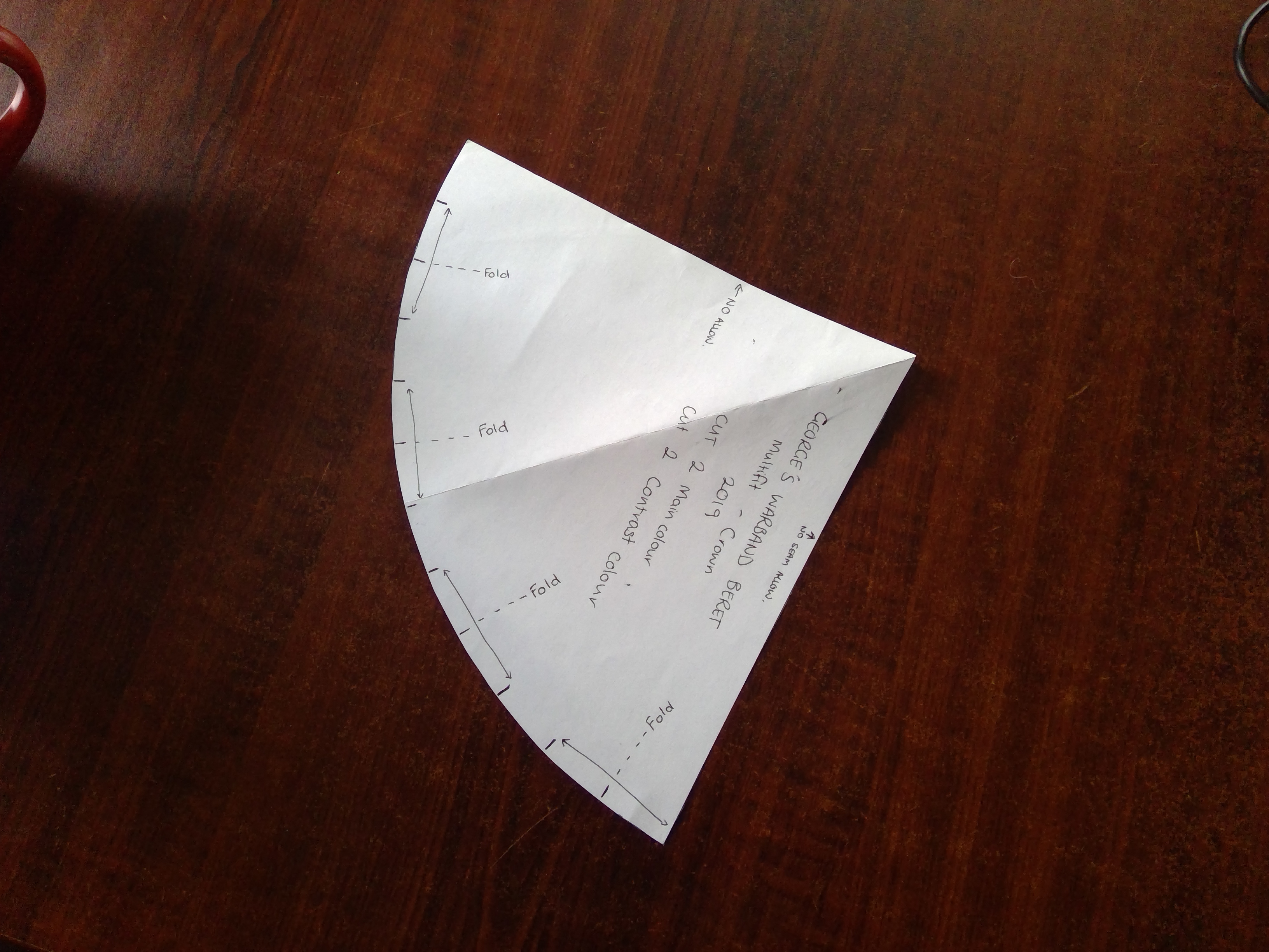

I’ve been through the forum already and seen a few threads from a couple of years ago, and I’m wondering if there’s been any updates on how to mark pleat placements on a pattern piece?
Specifically, I want to mark pleat placement on a concave curve. Nothing in the manual or in the forums that I have found thus far shows me anything useful, so I turn to you lovely folks for help!
Hi & welcome, @Ylva
Can you show me a picture or diagram of what you want to do? I’m thinking that the best way would be with internal paths. If I have a diagram, I can test if it works and give you a better reply :slight_smile:
Sure thing! I have already drafted the base pattern I want on paper, and I’m trying to put it into a digital format. (I also need help with the grading/multisize stuff, because everything I’ve read so far has me hopelessly lost!)
Ok, I’ll get back to you in a few minutes :slight_smile:
This is what I’ve quickly created for you using internal paths. You can change the line styles to make them more clear, if you wish. You won’t be able to add labels to each fold line because the program only allows for 2 labels:
