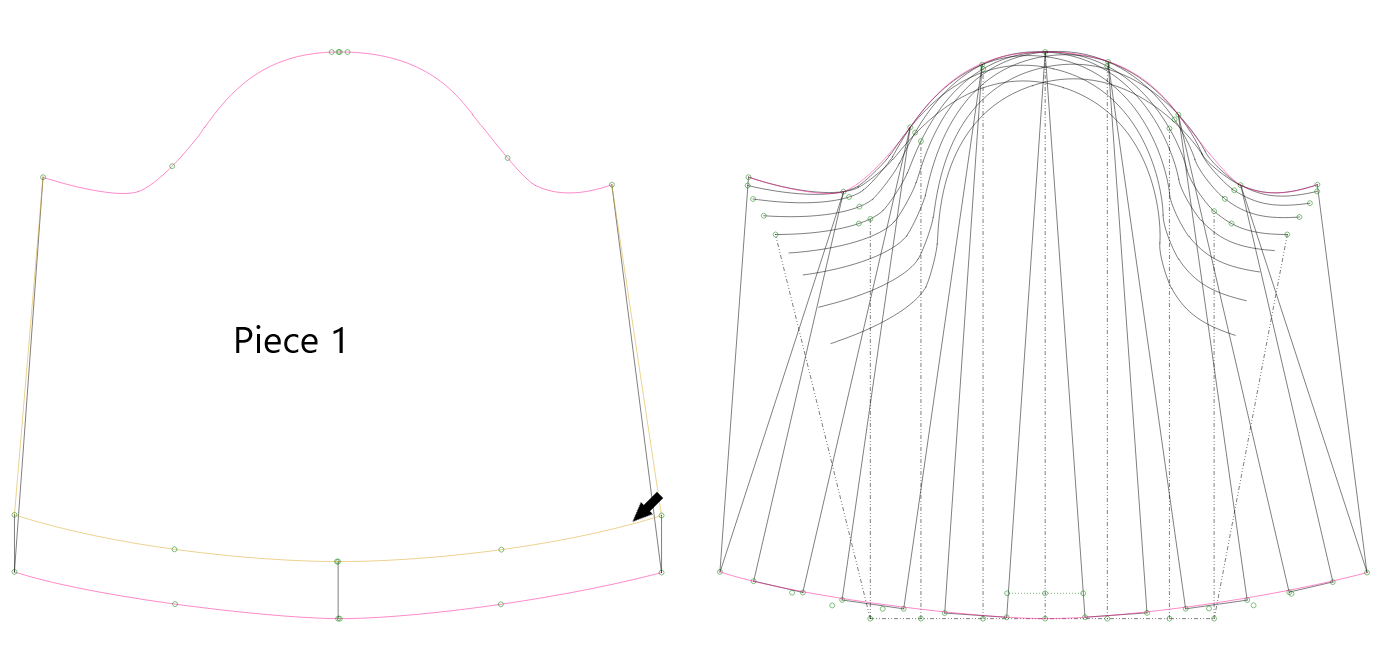

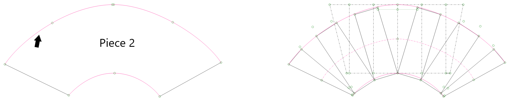

I have a problem and I don’t know how to solve it, let me tell you. I’m making a multi-size pattern of a lantern sleeve in Seamly2D.
The question arises because the curvature measurement of piece 1 doesn’t match the curvature of piece 2 for each of the sizes and I don’t want the fabric to be embedded, I want it to have the same curve length in both pieces. (Right now this curvature changes independently in both pieces, but it should be dependent).
How can I make the curvature of piece 1 (yellow line) the same size as piece 2, as it varies from size to size?
Sorry, but I can’t send the file because it is for a customer, I insert screenshots.
Thank you very much,
Esther

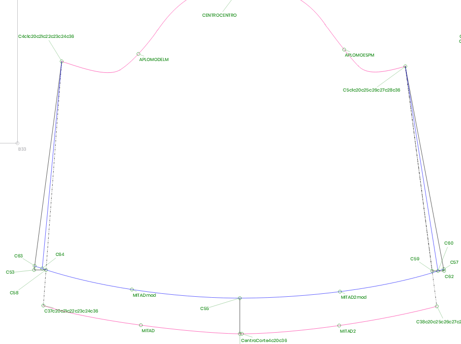

Thanks to all of you for your contributions. Now I explain how I did it:
It’s not as professional as @Grace’s option but it works :blush: Grace proposed to reduce the measure or height of the second piece but I wanted it to be fixed. I wanted it to measure always 14 cm high, like the original piece from which the sleeve transformation starts.

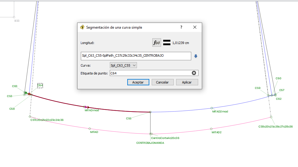

For that reason, I changed only the curve of the piece 1. First I increased the size of the curve by 1.5 cm on each side and made the underarm seam in both cases the same. Then I divided the curve in two, both starting from the centre.
Once these changes were made, I applied a node corresponding to the half of the curve of piece 2, and as it is dependent, it changed for each size, so there is no more embedding! I did the same for both halves.
I attach pictures
