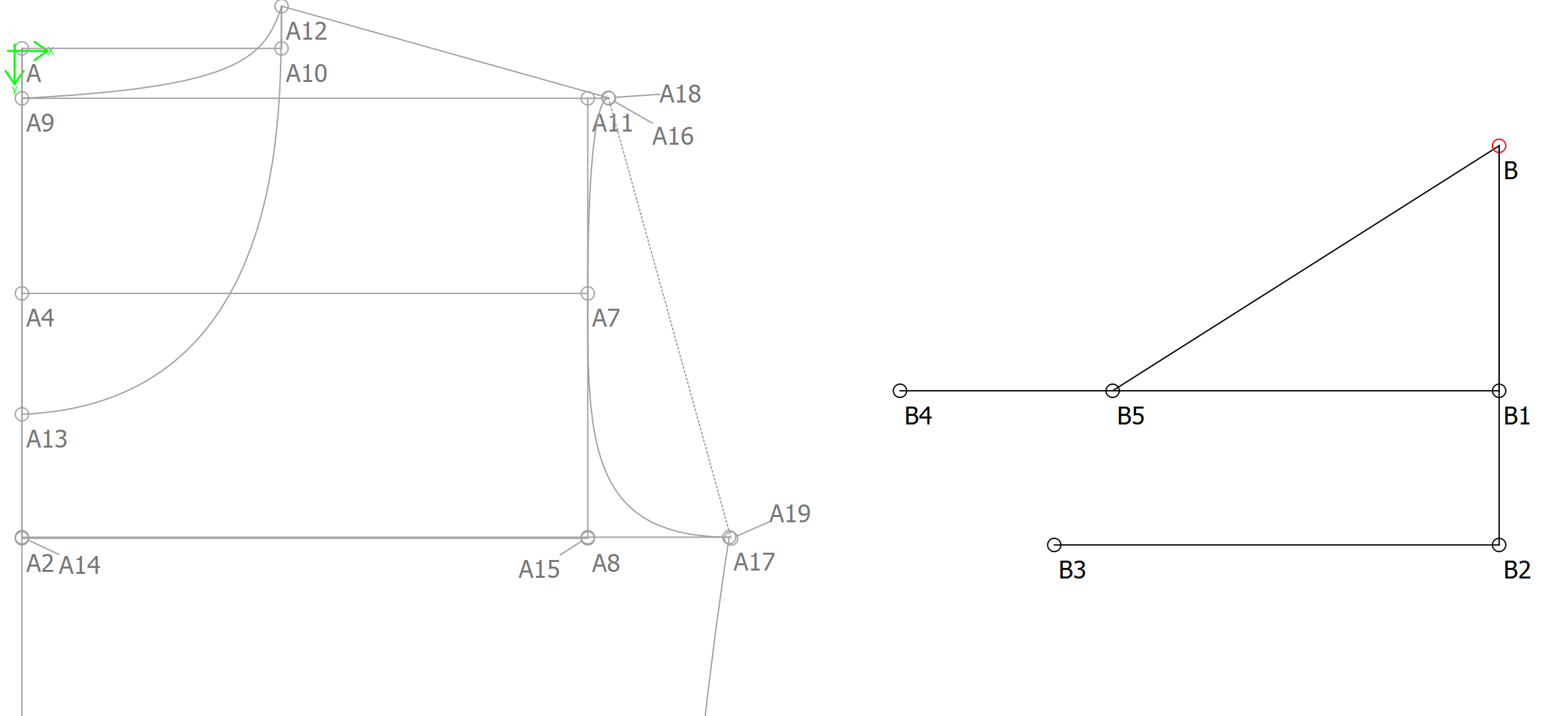

Now i struggle in Seamly how to draw a āfrench curveā to the sleeve. I have read the ebook, but donĀ“t understand completle what tools to use. ( also english isnĀ“t my first language

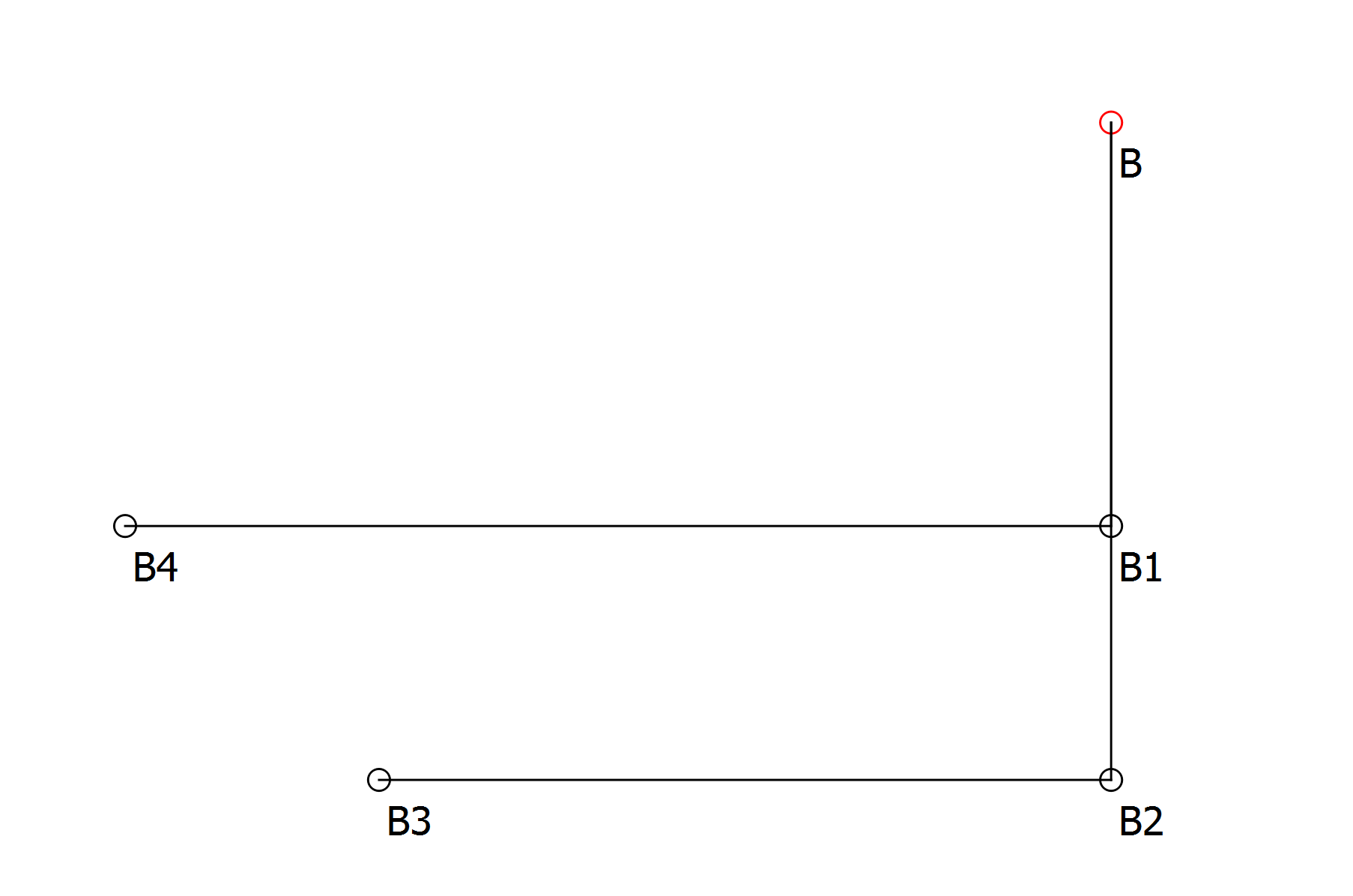

Is there a tool that i can mark the first point (B) and then enter the lenght (say 10cm) and what line it shoud cross (B4)? I will try to add a picture in here.
I found that tool (point at intersection of arc and line) and manage to do that line B to B5.
I have checked twice my measurerments, but still dont understand why the sleeve drawing is wrong. B5 should be the farest point from the B to B2 line?
Adding picture from my drawing.

Which instructions are you using to create your T-shirt pattern? The tool āPoint at Intersection of Arc and Lineā is the correct one to create the shoulder line of your pattern, But the distance from B to B1 seems to be very high. Iāll need to see the instructions that you are using and the measurements need to be taken according to the instructions. If you can let me have both the .val and the .vit files, Iāll be able to see what you are trying to do and advise you accordingly.
Looking at your pattern, there seems to be a problem with the armscye depth on the bodice. On the pattern, it looks like this:
You can see that the neckline falls above the line from E.
While on your pattern, it falls below the line:
In the interest of āteachingā I see that you have created nodes on top of nodes in an effort to get the lengths of the lines. I also did this in the beginning until I learnt that drawing a line between 2 nodes using the āLine between 2 pointsā tool would give me the measurement if I just hover the cursor over the line. It also makes the length of the line available in the formulas.

Ok, I see this is more a preference and the image on the drafting page is more for a very close fitting T-shirt at the neck.
Here is what my pattern turned out like
