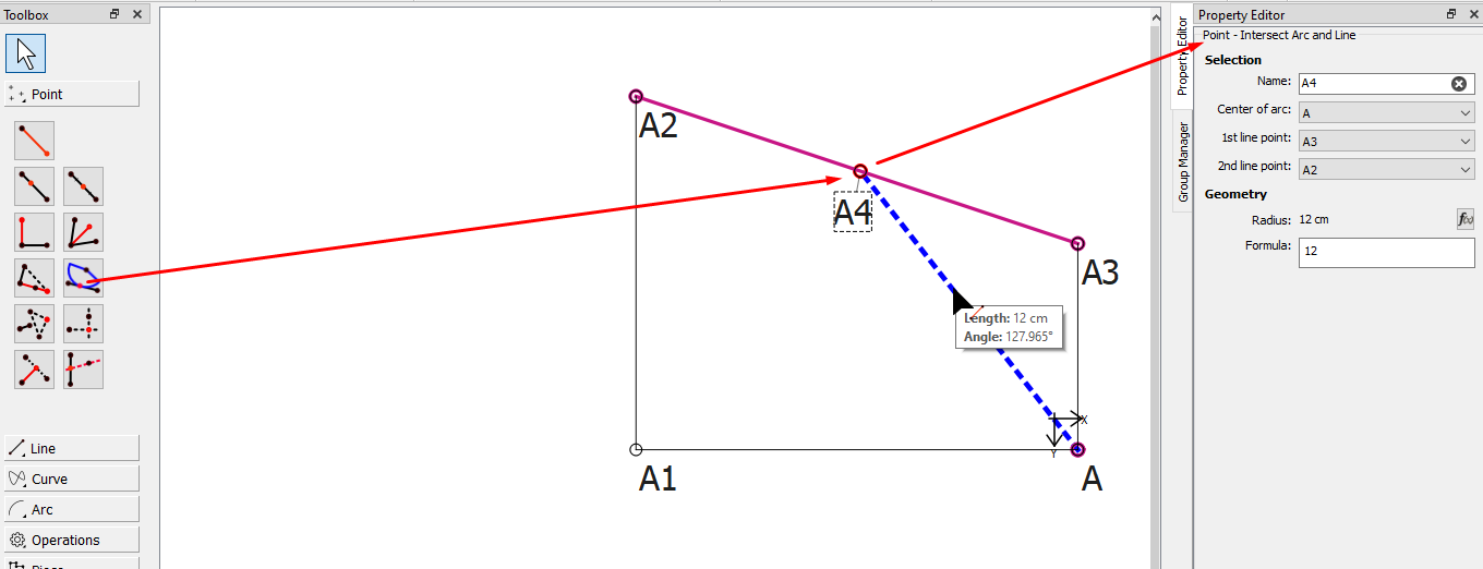

How to draw exact length using "point - intersect line and axis" tool
Using “point - intersect line and axis” tool, how can I draw Line_A_A4 at exactly 12 cm. I’m fine with math formula or other tools workaround.

There’s a very neat tool to do this. Point - Intersect Point & Line. Select the tool, click on the 1st point of the line & then the 2nd point of the line, then select the point from which you would like to measure from, and you’re done. Just draw in your line:

Thank! It works perfectly.

Well first of all that’s the Point - Intersect Arc and Line not the Point - Intersect Point & Line… but I’m just pointing out that the icon is confusing with that “blue” thingie that doesn’t show the radius from the Arc center to the Intersect point… which is the whole objective of the tool.
It’s needs to be more like:
