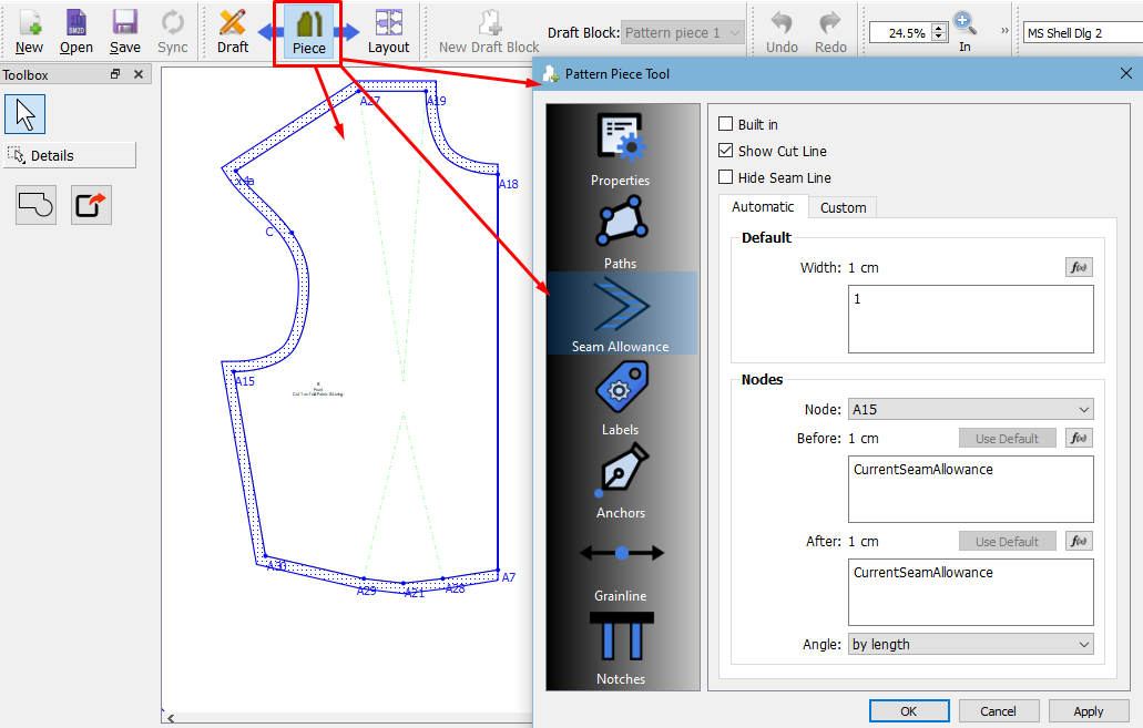

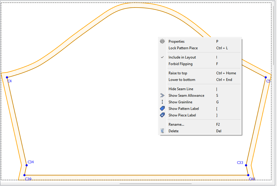

In Piece mode, you can right-click on any pattern piece to edit the seam allowances. Click on the Properties, select the Seam Allowance on the left, then you can edit the before and after SA for each node or set a default:

Hi Sara…

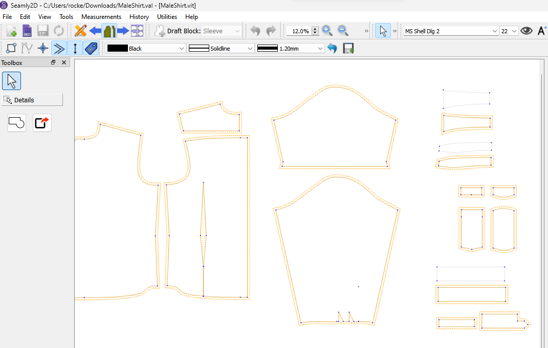

You have to switch to the Piece Mode screen to be able to edit the Pattern Pieces. Click on the Piece mode button on the toolbar to switch.
Screenshot 2024-01-20 161607
You will now be in Piece mode where you can see all the pieces that were created in Draft mode.
From here you can as @Grace pointed out use the Right Mouse on any piece to select Properties to open the Pattern Piece Tool dialog to edit the properties.
BTW… there will also be displayed a list of Pieces in the Pattern Piece dock off to the right. You can also open the Pattern Piece Tool dialog by double clicking on any piece name in the list.

Just to add to what @Douglas told you, yes, you can only edit the 2 options after selecting your lines for you pattern piece. Once you click on OK, you will be able to access your pattern piece in Piece mode where you will be able to edit everything.
