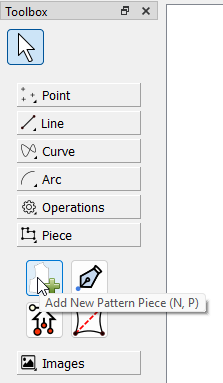

Once you have finished drafting your pattern, then you need to create the pattern pieces. To do this, you need to select the Add New Pattern Piece tool:

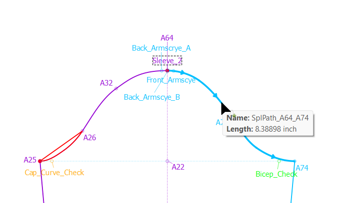

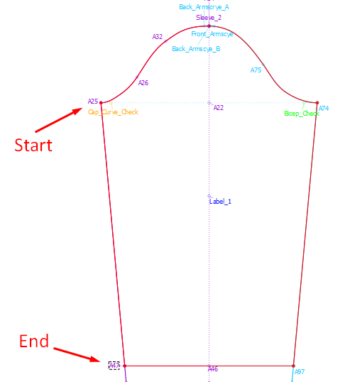

Click on each point and curve on the outline of your pattern:
Continue around the pattern piece in a clockwise direction until you have clicked on the last point or curve before the starting point, and hit Enter:
(Be sure to select the point at the start and at the end of a curve.)

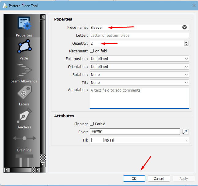

Give your pattern a name and a quantity to be cut (or On Fold) and click on OK:

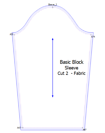

Then you can go to Piece mode to add labels and to export your pattern:

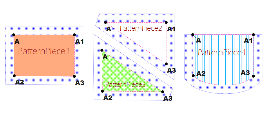

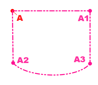

Exactly. A draft block is there only to create the points and curves. Then you connect the points and curves to create Pattern Pieces. You can create any number of pieces from the same block. For ex:
Draft Block:
4 Different Pattern Peces traced from Draft Block:
The seam allowance , labels, colors, fills etc are details added to the pieces in Piece Mode.
