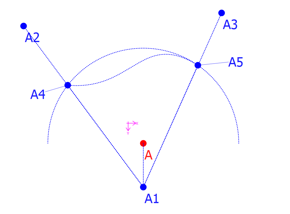

Yes that does work. However I was trying to do something like on the example. Where A4 and A5 both lie on the same arc and I now want to find the middle point along the arc between those points. I have created an exaggerated example to help making it clear. The length if the curve between A4 and A5 isn’t known, yet I need it to divide it into parts. IN this case it could probably be done by drawing a line between A4 and A5, then drawing a line from A1 through the middle of that line. But that only goes when the arc is a perfect circle and both helper lines (A1-A4 and A1-A5) stem from the same origin. This method however fails when the circle is rather a spline. See second example. In the end I just eyeballed it. The original instructions read. Draw a smooth curve and find the middle along its path. Perfectly doable with a ruler, not so simple for me doing it electronically. Image 002

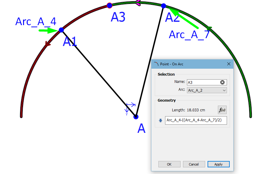

Use the image tool and in the formula use the ((length of the arc to A4 - length to A5) / 2) + length to A5.
Unfortunately you have to decipher the which curve length is which in the Variables table, as the names are not based on the point names, but rather the order in which they were created.
You can use the info in the rollover to figure out which length is which. image

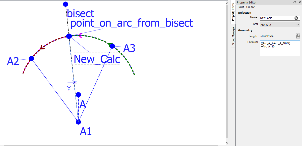

Here is the same as @Douglas showed you, just minused off the A1 on the arc. It takes some testing to match the arc name to the nodes.

You can test the arc’s label to see which section the arc in the list belongs to by entering only 1 arc at a time and hitting Apply instead of OK. The arc section will highlight and the new node will fall on an existing node. Once you know which arc will fall on the 2 nodes needed, then you can do the rest of your formula.

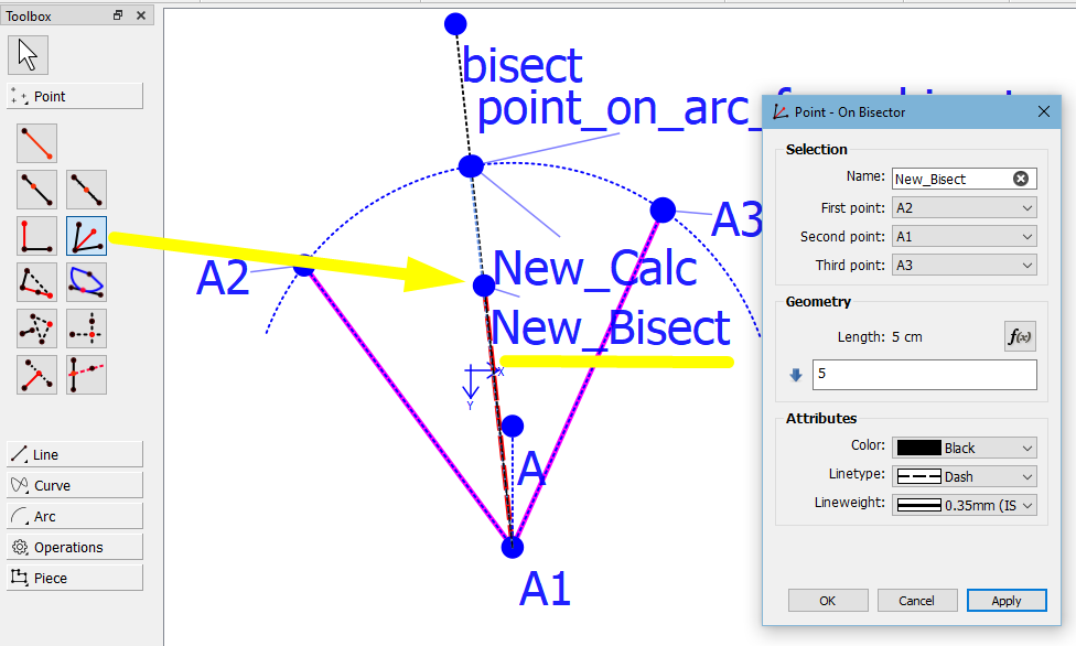

And if you want to place a line between 2 lines there’s also a tool for that (just for future FYI)…
Here’s your test back so that you can see what I did…
test A.sm2d (2.1 KB)
