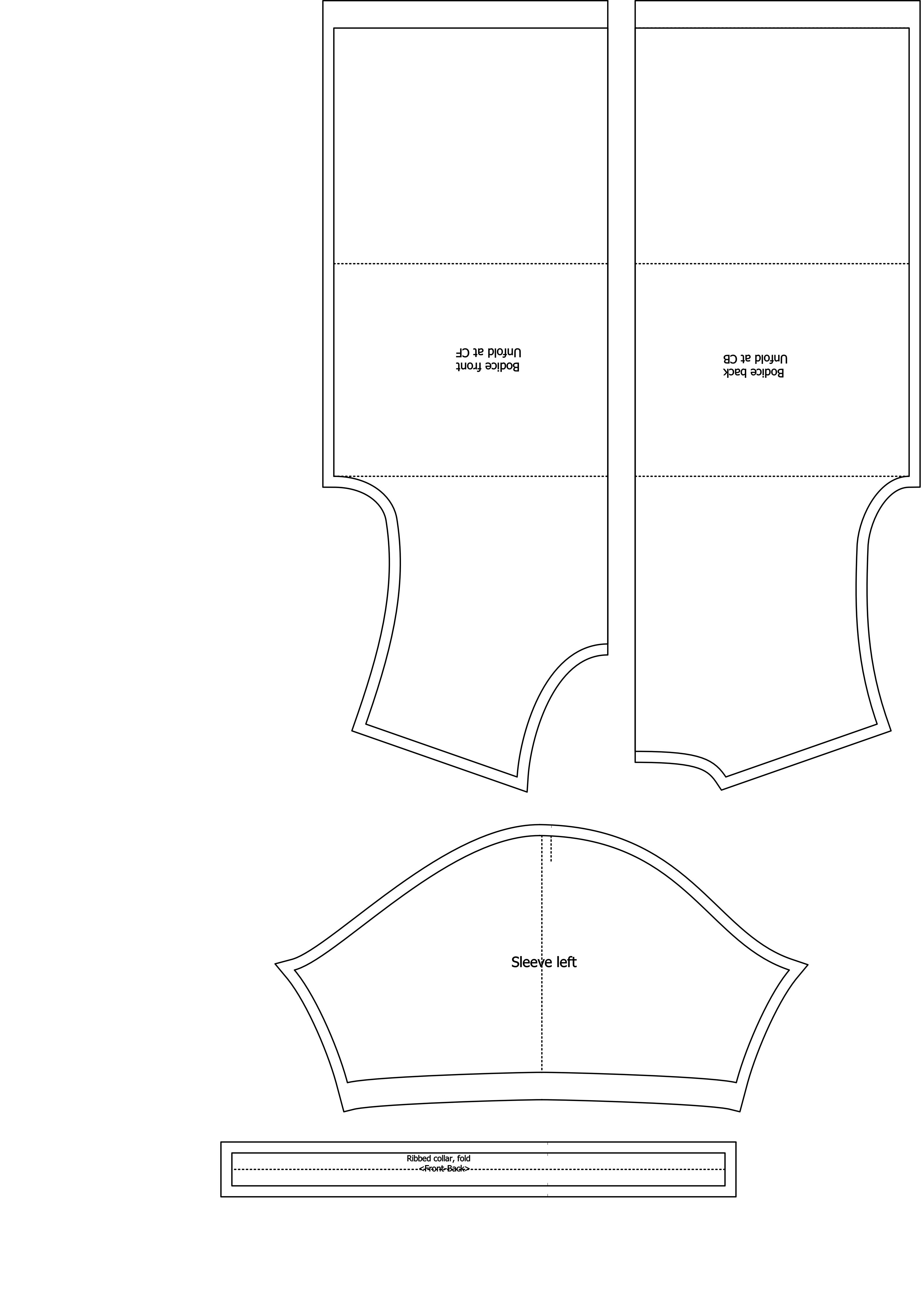

How to "forbid flipping" vertically in layout?
From my experience, the “forbid flipping” option prevent flipping, but only horizontally.
Is there a way to prevent vertical flipping? I know it does not matter for printing, but I want all my patterns to be upright for presentation purposes.
Butterfly Male M - T-Shirt 240321 [for print].sm2d (35.3 KB) Butterfly Male M.smis (2.5 KB)
On second thought, the pattern is not flipped but rotated 180°, so the “forbid flipping” option works as intended. Is they any way keep the pattern upright?
