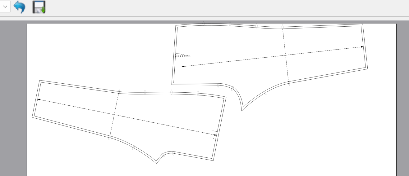

How to forbid rotation in layout?
When I get to Layout mode, Seamly rotates my pieces and I cannot figure out how to prevent it.

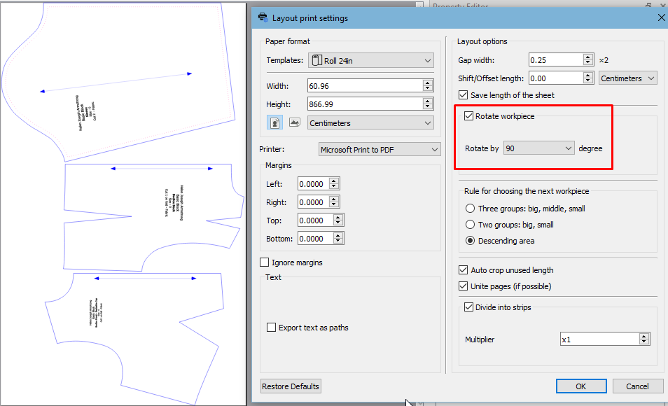

However, the best I could get in Layout mode is as above. It’s still rotating the sleeve, but by setting the rotate to 90° has placed the 2 bodice pieces next to each other very neatly.
I hope this helps you.
