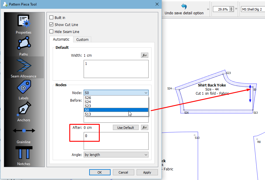

Right-click on the pattern piece to open the Properties, go to the Seam Allowance tab and under Custom, choose the point that you would like to change. In the Before or the After, enter the amount that you would like the Seam Allowance to be. In this case, I’ve already changed the value to 0 at point A13, in the Before, and am now changing the After value to 0 because this gets placed on the fold:

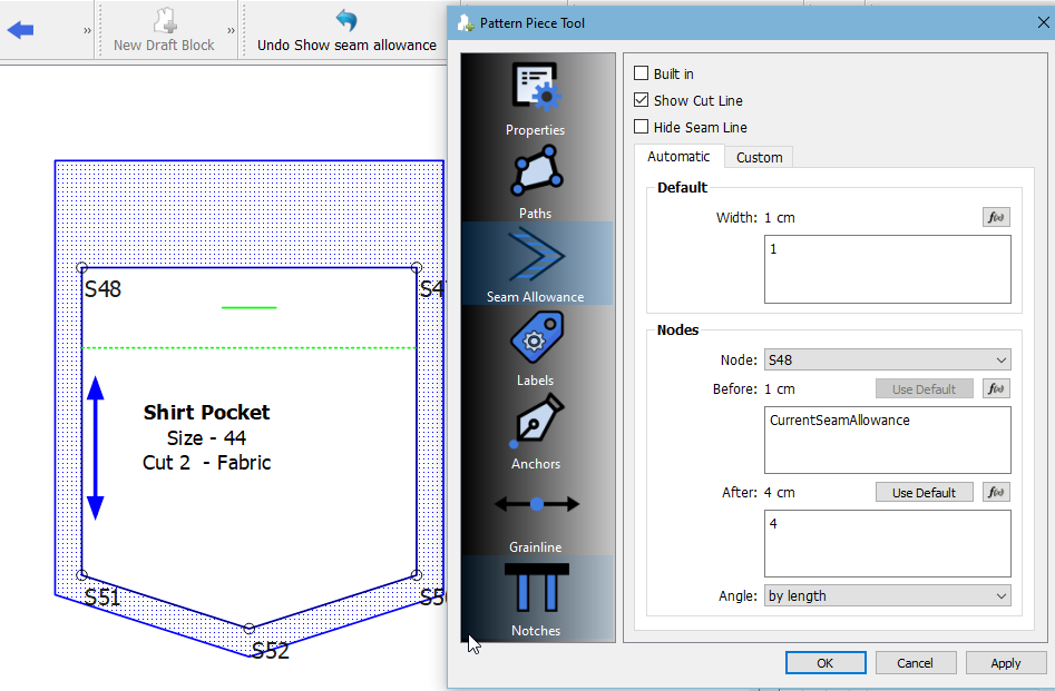

Here is an example of a seam allowance for a hem:
