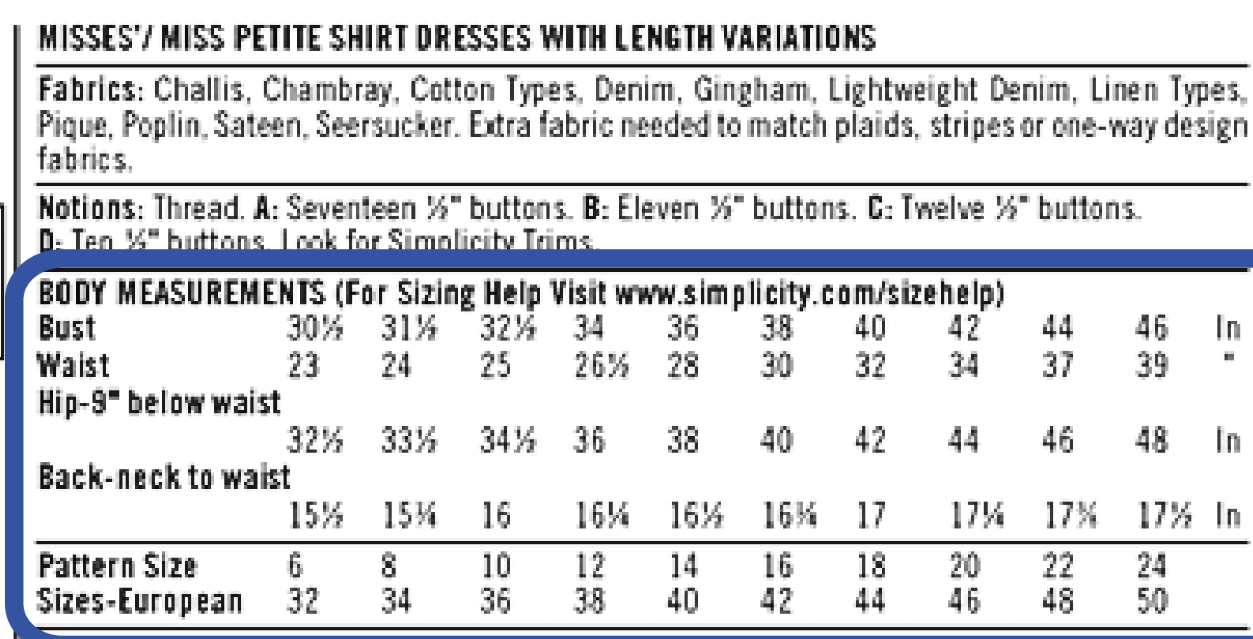

Grading IS resizing according to a set of grade rules. Multisize measurements are the grade rules. Grading is the process of taking a base size pattern, and then increasing or descreasing the size according to the grade rules. For example… looking at a chart for Misses:
If we take the waist… from size 6 to 10 it “grades” up 1", from 10 - 14 it grades up 1 1/2", from 14 to 24 it grades up 2". You may notice that the rule bust and hips differs. This is what the multisize measurements are for… to set up grade rules according to what body type you want to fit. Unfortunately we’re currently stuck with only centimeter values for size designations.
