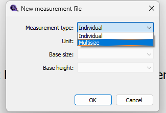

Open SeamlyMe… select New. Select Multisize

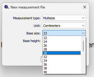

Select base size… and base height (which you probably won’t need).
Then you have to add your (known) measurments for the base size value and the increment to increase or decrease from the base size. Again @Grace can probably explain better than I can how to configure your basesize and increments.
