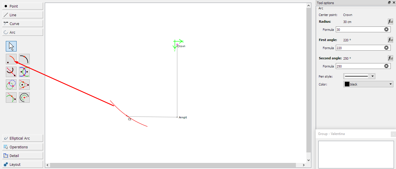

I used the Arc tool from the crown using the calculated diameter and then the Intersect Arc and Axis tool to place the point C1 at a 180 degree angle from the armpit:
You may draw in the line from Crown to C1 using the Line tool.

Thanks for your reply! I tried the arc tool and what does it mean by first angle and second angle?

Going counterclockwise … Angle1 is the number of degrees from 0… angle2 is the number of degrees from 0… the arc is between the 2 at radius from the center point… maybe this will help to visualize: I used 45 deg for angle 1 and 135 for angle 2.
arc
The normal directions on a compass work anti-clockwise. So 0 is a straight line from the axis point to the right, 90 is straight up, 180 is straight to the left and 270 is straight down.
If you look at the first image I posted, I used 220 for the first angle and 250 for the second angle.
This means that the arc will start below 180 degrees at 220 degrees and will end at 250 degrees, which is before 270.
The axis point is, of course, the Crown point from which you’d like to measure from.
These can be edited on the right side of the drawing board until the arc covers the general area where you’d like to place your point.

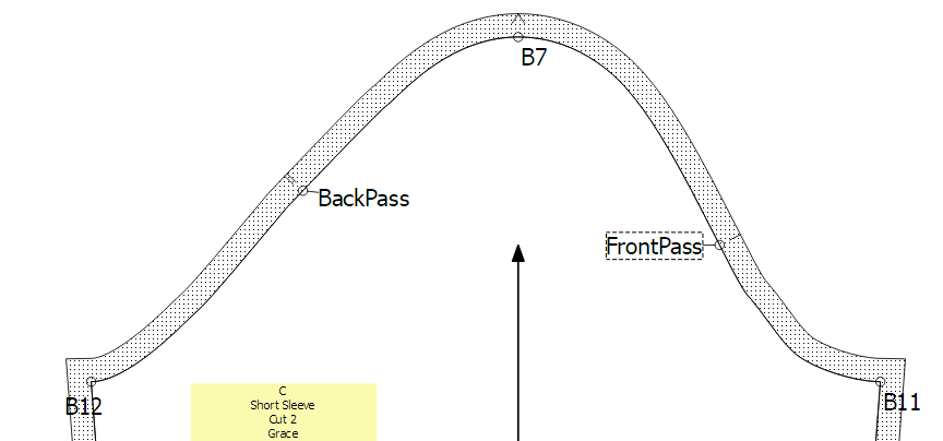

Notches are called passpoints which are added to nodes by right-clicking on the node and selecting passpoint when you have created the detail and show in the seamline. You can edit the type of passmark on the right of the Options menu at the bottom.
I add a node at a specific distance from the armhole edge of the curve by using the segment a curve tool:
Because I’m still learning (or lazy) and am not too particular about sewing in ease stitches between the 2 notches, to fit the sleeve cap into the armhole of the bodice, I measure the notches from the armhole to the corresponding point on the bodice.
