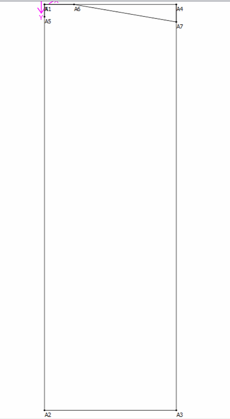

Is there a way to mirror the 1/2 pattern on the block?

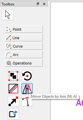

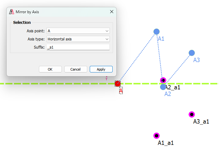

For mirroring by axis - vertical or horizontal: select the Mirror by Axis tooL

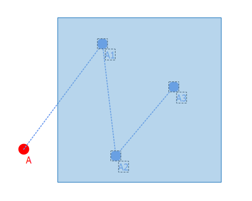

The select the objects you want to mirror.
You can either select them one at a time or “rubberband” around the objects you wantto include:
The objects will be hilghted with the dashed line box:
Press Enter:

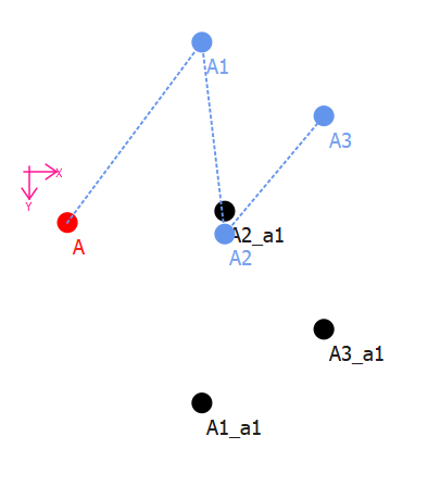

Now select a point that is NOT one of the point you selected to mirror:

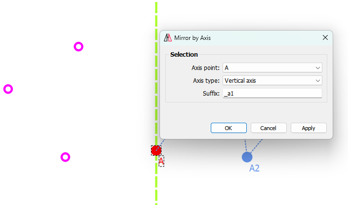

The Mirror dialog pops up… select whether you want to Mirror Vertically or Horizonrally based on the Axis point… note how the tool shows you the selected points in your hilight color of choice:
Click OK.

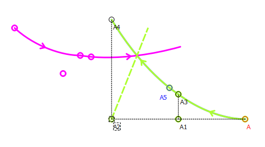

The Mirror by Line operates in a similar fashion except you are going to select 2 points for the line that are NOT objects selected to mirror.
Again… follow the tooltip instructions in the status bar… they basically tell you how to use each tool:

After selecting the tool I lasso select (drag drop) the nodes and press enter nothing happens just like i show on the video. (The nodes should turn blue but they dont)
Selecting nodes one by one via CTRL + Click does not work as well.
Yes, I press enter. after doing all of those but again It does not work.
Right… FOLLOW the tooltips in the status bar. Depending on which Mirror tool you are using after you Press ENTER it will then say…
For Mirror by Axis:
Or
Mirror by Line:
followed by
Which then interacrively shows the visualization of how the objects are mirroring until you click the second point:
These steps are similar in ALL the Operatipns tools.
