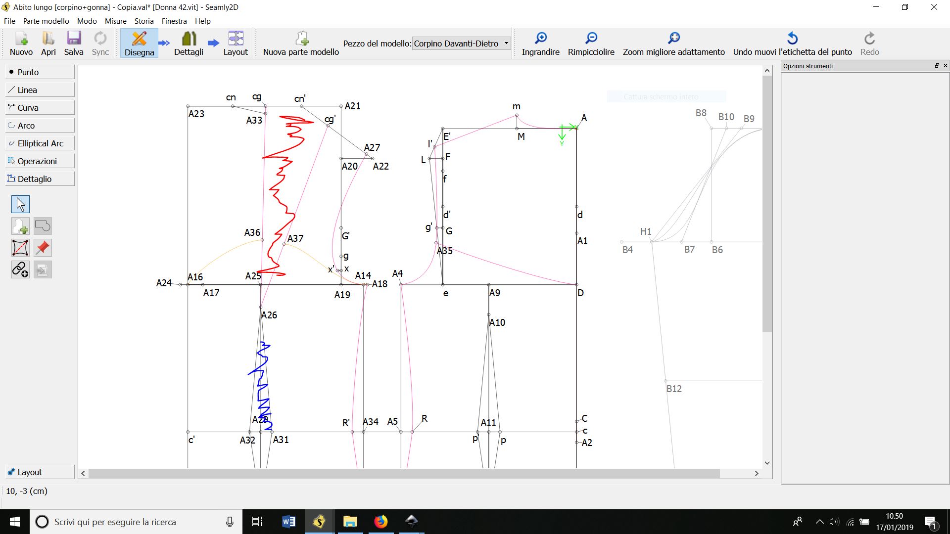

Good Morning. As you know, to have the right breast fitting of a woman bodice, we must nullify a specific pattern area (please tell me if my terminology is wrong :slight_smile: ); we call it “cuneo” in italian. Here you can see the screenshot with a red mark where I want to “merge” the line A33-A26 with A26-cg’, and the blue mark where I want the pattern to open consequently.
How can I obtain that?
@luca_lavore I believe the English term “slash and spread” is related and I believe you need to look at the rotate tool. @Grace will probably be more helpful than I can. In English I would call the area that you have marked in blue a DART

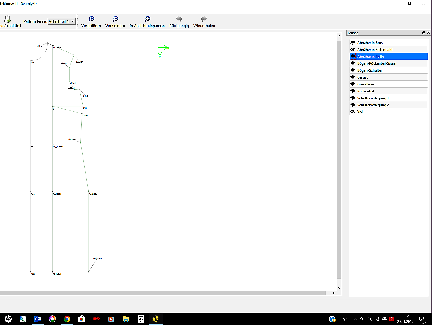

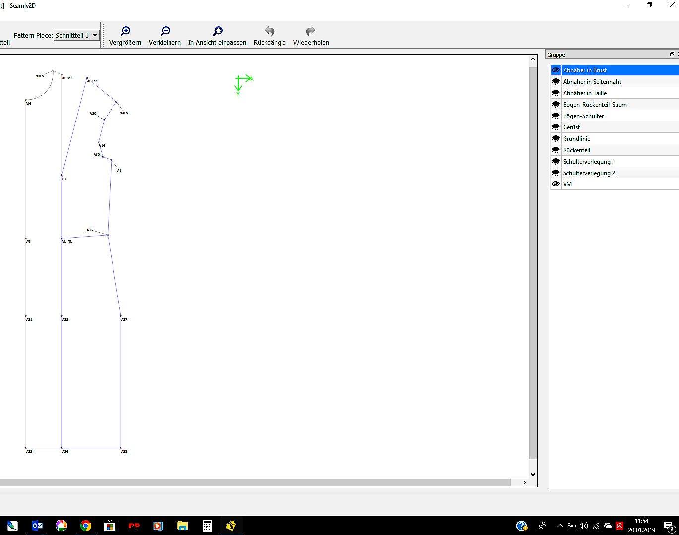

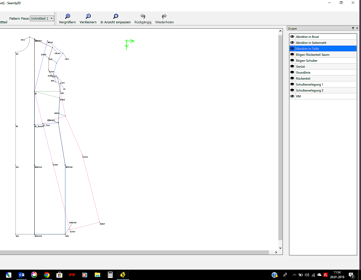

I also used the rotary tool for that. So that I can work meaningfully with it, I have created a framework and then formed individual groups:
  1. darts in chest
  2. Darts in waist
  3. Dart in side seam 4th VM - is always the same
The back part is in a different group, so I am able to work only on the front part
At my first try, I have already drawn the curves of armhole and side seam. It then turned out that it is not or very difficult to get the corners to other points. The whole thing became very confusing.
Now I have, for example I created points for the neck hole and the shoulder point on the shoulder line, which I can then push back and forth on the shoulder line.

Oh, wow! Very well done!!! I see you have mastered the rotation tool :slight_smile:
Good job @Scholli. I had not thought about combining the group tool with the rotation tool.

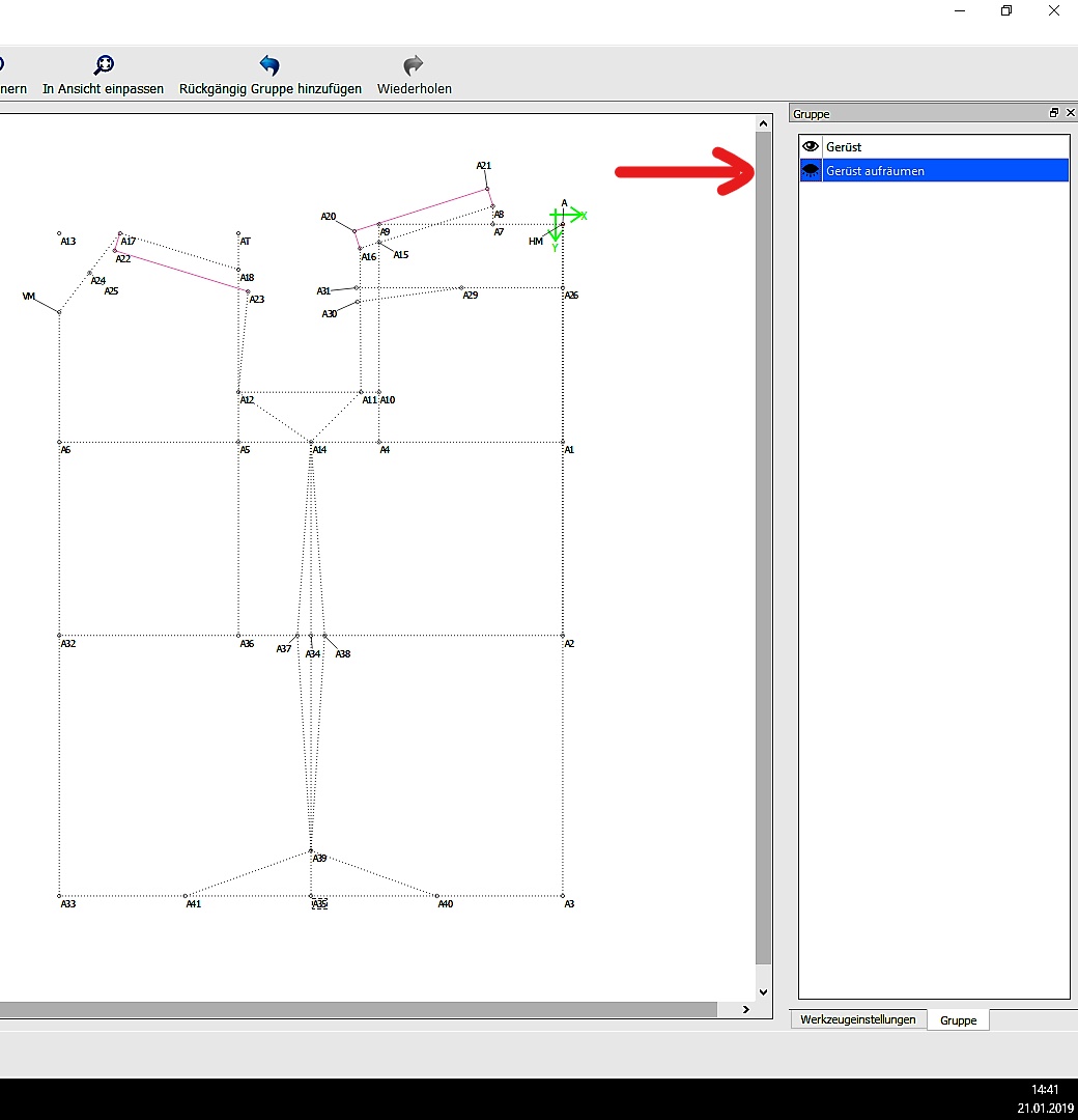

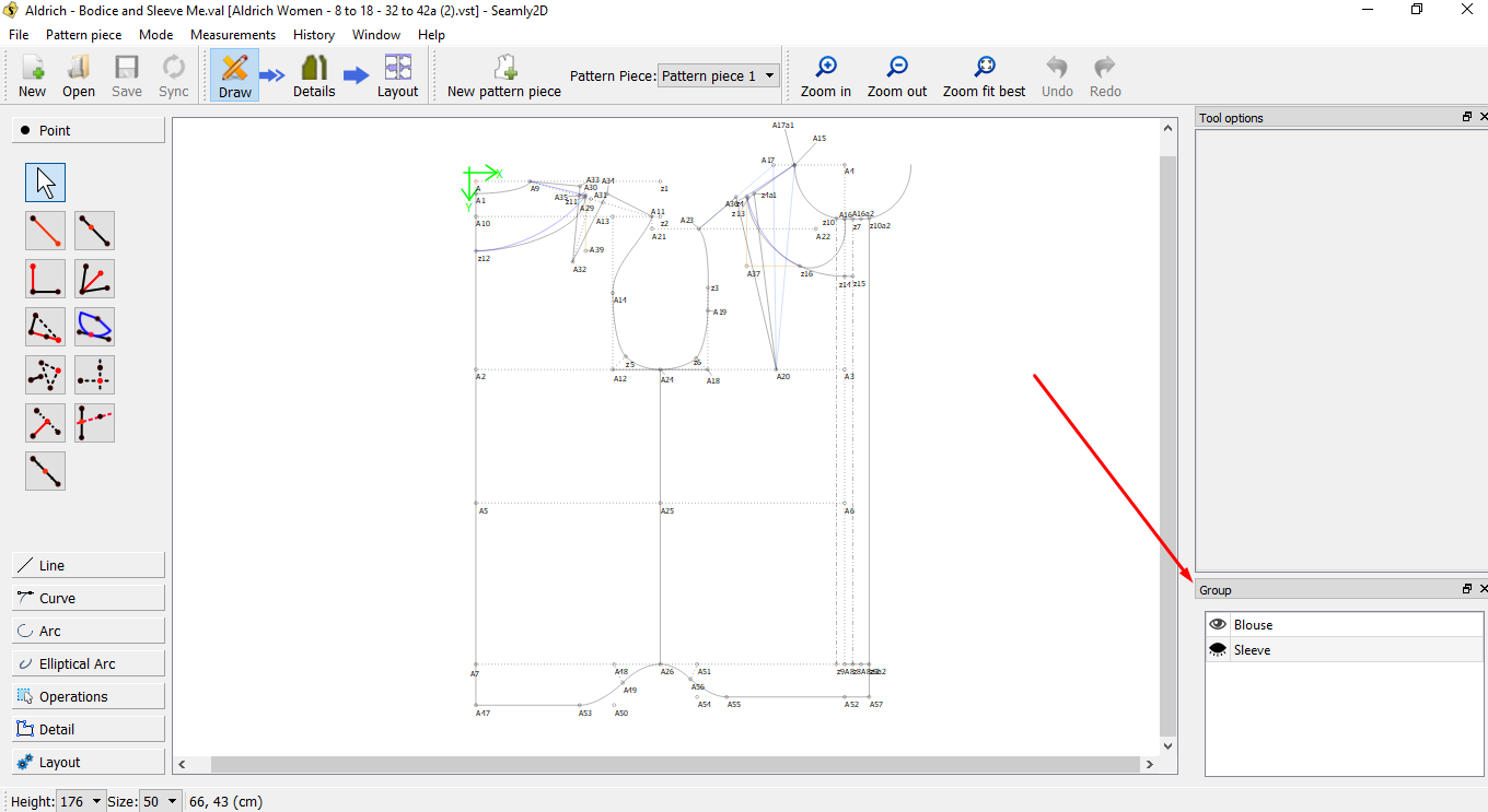

On the bottom right, the groups should be listed.
If they aren’t listed, then right-click the gray bare that says Tool Options and click on Group:
This will open an area where your groups are listed. Then you can click on the eye next to the group name to make it invisible or visible (closed eye or opened eye) - as you can see in the first screenshot.

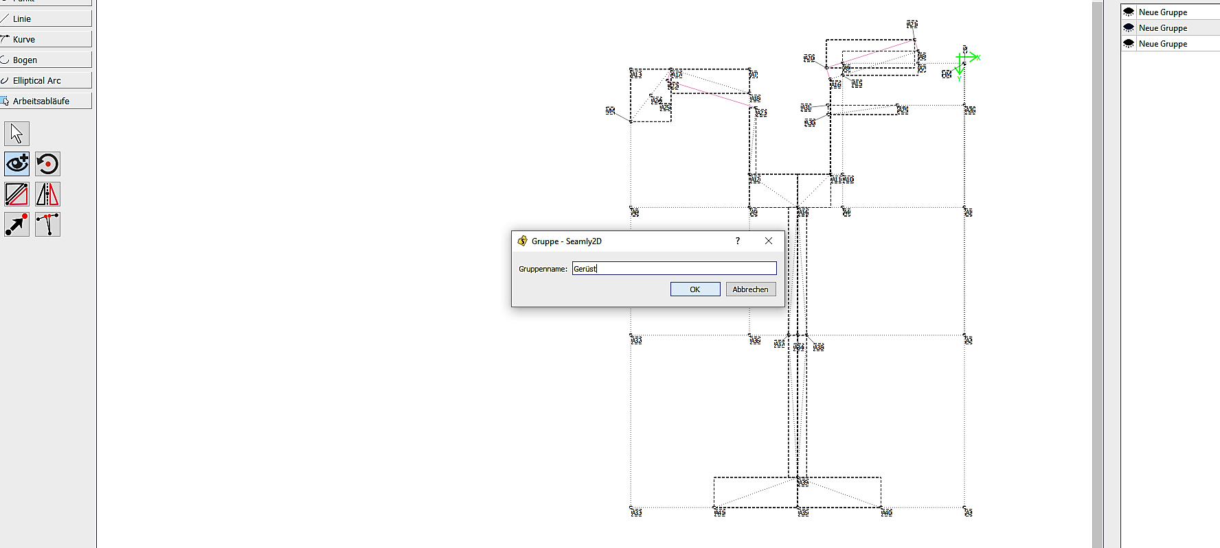

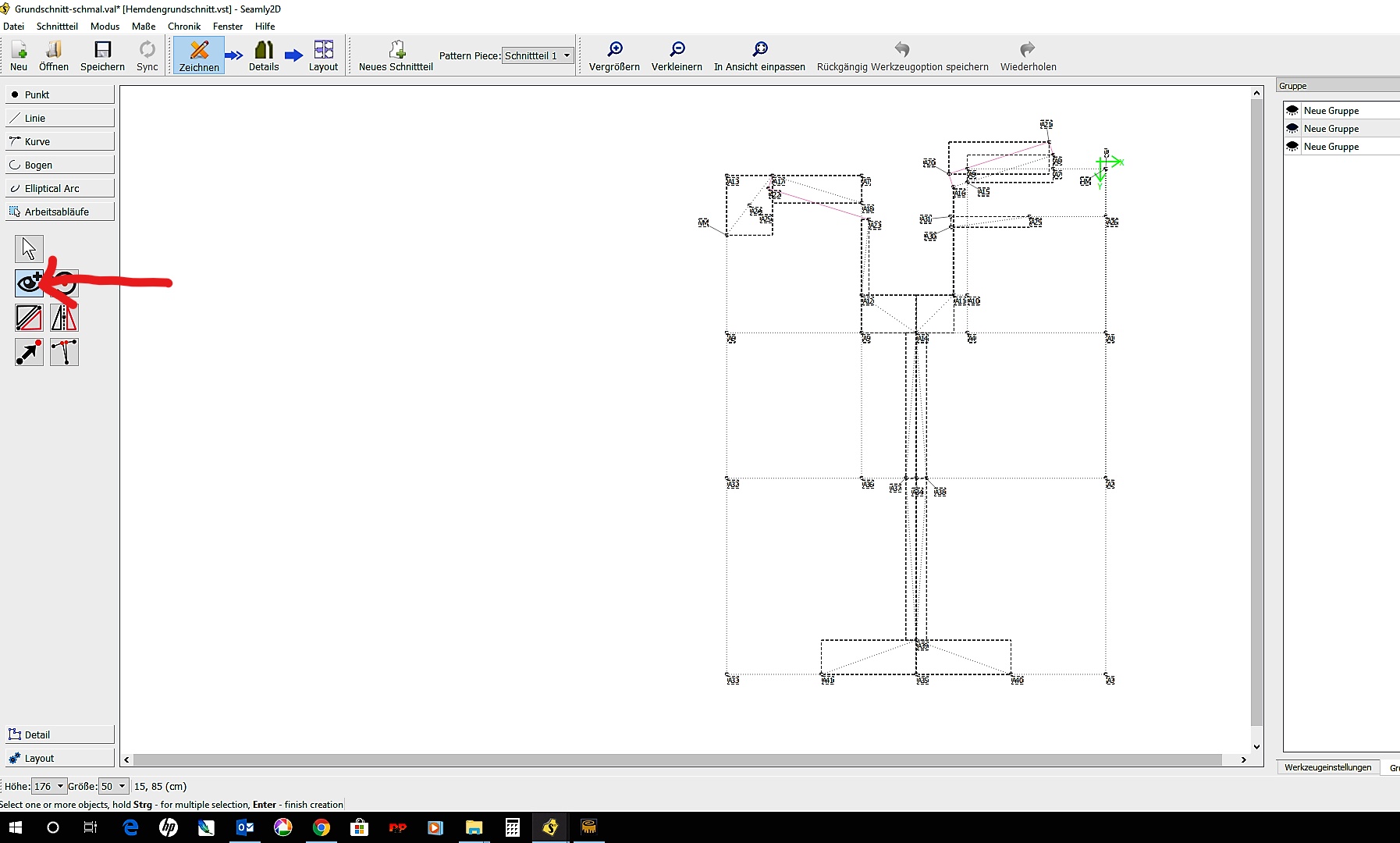

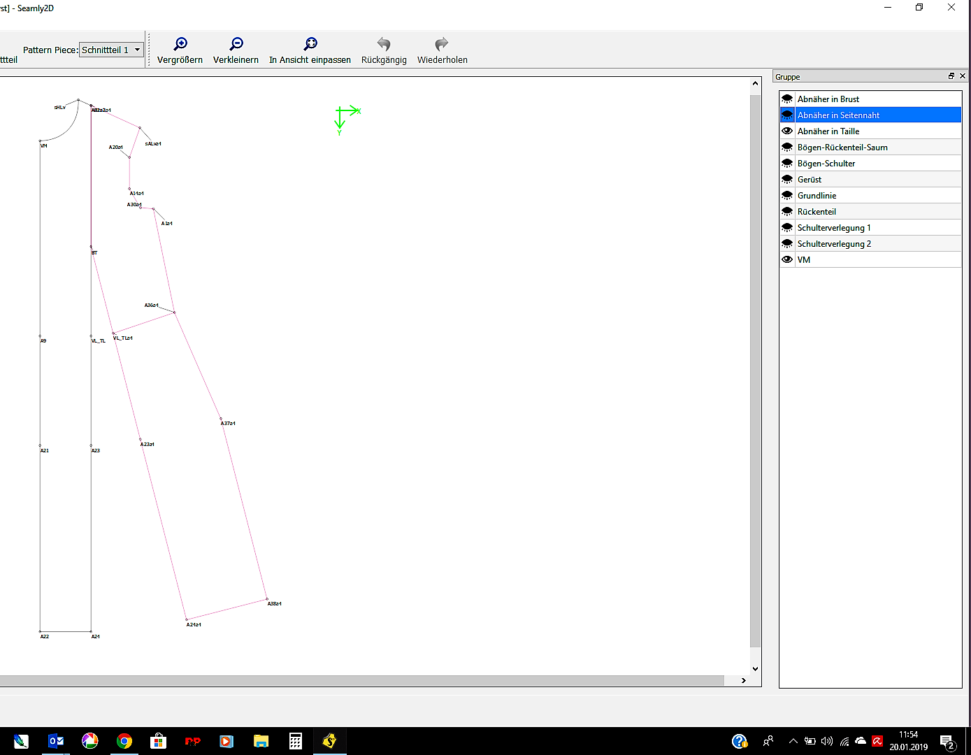

das ist eigentlich ganz einfach: Ich arbeite gerade an einem Grundschnitt für ein Herrenhemd. Das Gerüst ist bis auf den Ärmel fertig. Im Bild siehst du wie rechts schon neue Gruppen stehen. Das Auge ist zu, das heißt du kannst die Punkte nicht sehen. Ich möchte immer auf das Gerüst zurückgreifenund und möchte eine Gruppe bilden.
Unter Arbeitsabläufen siehst du das Werkzeuge: Auge
Mit der Maustaste ziehst du komplett über das Gerüst, dass du gezeichnet hast und drückst auf Enter. Daraufhin erscheint ein Dialogfeld. Du kannst der Gruppe einen Namen geben: Gerüst und drückst dann auf OK.

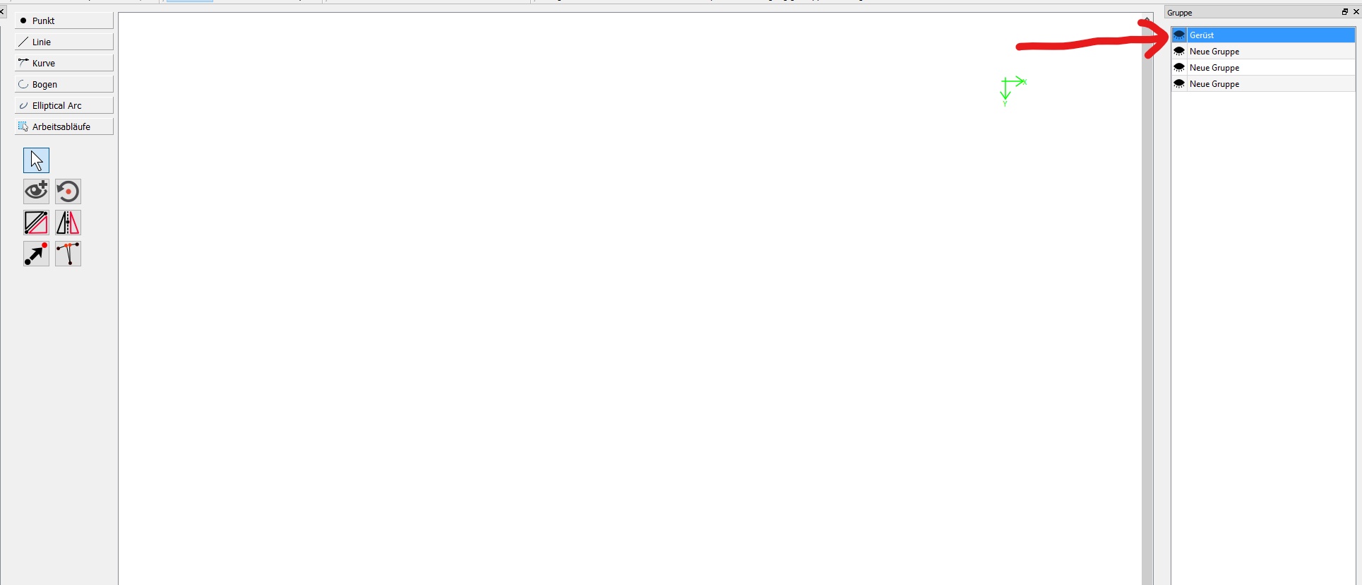

Diese Gruppe siehst du nun rechts stehen. Das Auge ist offen. Drücke auf das Auge. Dann ist nichts mehr zu sehen.
Wenn ich jetzt die anderen Gruppen öffne, sehe ich die Punkte, die ich vorhin versteckt habe. Ich hatte den Gruppen keinen Namen gegeben. Ich werde sie jetzt bündeln.
Dafür Lösche ich die neuen Gruppen mit der rechten Maustaste. Ich kann sie umbennen oder löschen. Jetzt kann ich eine neue Gruppe bilden. Z.B. Gerüst aufräumen.
Wenn jetzt beide Gruppen offen sind sehe ich alle Punkte.
So habe ich immer die Möglichkeit Gruppen zu erstellen. Im laufe der Zeit sammeln sich immer mehr Punkte an. Die Zeichnungen werden immer undurchsichtiger und verwirren. Somit kann man gut Ordnung halten.
Man muss sich vorher gut überlegen wie man die Gruppen benennt. Damit kann man gut eine Abfolge bestimmen.

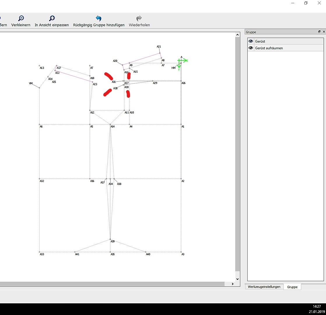

Other than that, groups work in almost exactly the same way as the rotate tool. Except that you will be selecting all the node, curves AND lines (while holding the Ctrl key) that you would like to put in your group.
Or you can drag a box around everything while holding the Ctrl key.
Press Enter and a box will pop up where you can name the group if you wish.
It doesn’t really change the pattern like the rotate tool does, but it will store the same or different nodes, etc. in a group so that you can see or not see them.
This is very handy for keeping your work space tidy so you can concentrate on what you are doing, and also, as @Scholli did, keep different versions of the same thing together.
