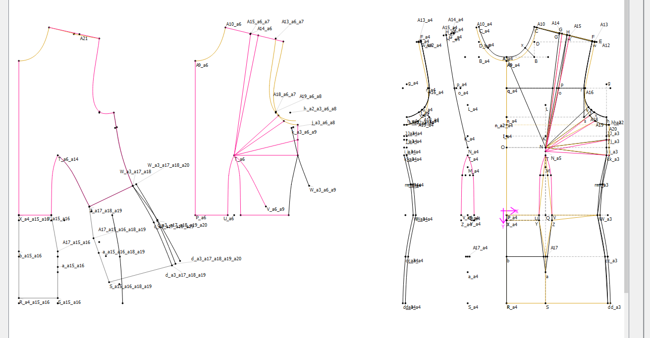

It’s only the groups that are so neat & tidy. If you look at the actual file with the groups open, you’ll get a fright:
And this is only the front bodice pattern. I haven’t begun developing the pattern for use yet, but this is an example of using the groups to keep your patterns really nice & tidy. I like to open only the ones that I need before creating the pattern pieces for exporting. It makes my life very pleasant :grin:
Haha, yes, but I don’t actually know how to do the dart manipulation properly. I have just been winging it using the rotation tool. If you can could you tell me how you draft dart manipulations? It doesn’t have to be in groups, just how you move the darts around to create the manipulation.
Also, here’s a picture of just how BADLY I was doing it:
I made this like 3 weeks ago when I still didn’t know much about Seamly, so I was trying to re-do it in a better way today, but I couldn’t figure it out. So if you could tell you how you do yours it would be really helpful!

It works exactly the same as it would if you were doing it by hand. You draw the line where you want the dart to go to & then you select all of the points and curves between the existing dart and the new dart (including the point where you want the dart to go).
In the angle formula box, you use the dart-leg angles of the existing dart (deduct the one from the other) to close that dart. which will rotate all of the other objects and will reveal the gap of the new dart.
Ohh, I hadn’t thought of using the dart angles! But how do you true the lines and curves when there are darts in the middle of straight lines and continuous curves?
I try to make simple curves from one point to another to avoid having to rotate large complex curves that stick out all over the show unnecessarily. This is probably why my rotations look so neat.
And then… if you true’d your original dart, the chances are that your new dart will be true’d already with the rotation.
True-ing the dart is just to make sure that the dart legs are the same length, so that when they’re sewn together, the one side isn’t longer than the other side. And that sewing them together won’t form a valley or a peak on the seam line. Since you’re moving items that normally fit together, this shouldn’t be a problem.
