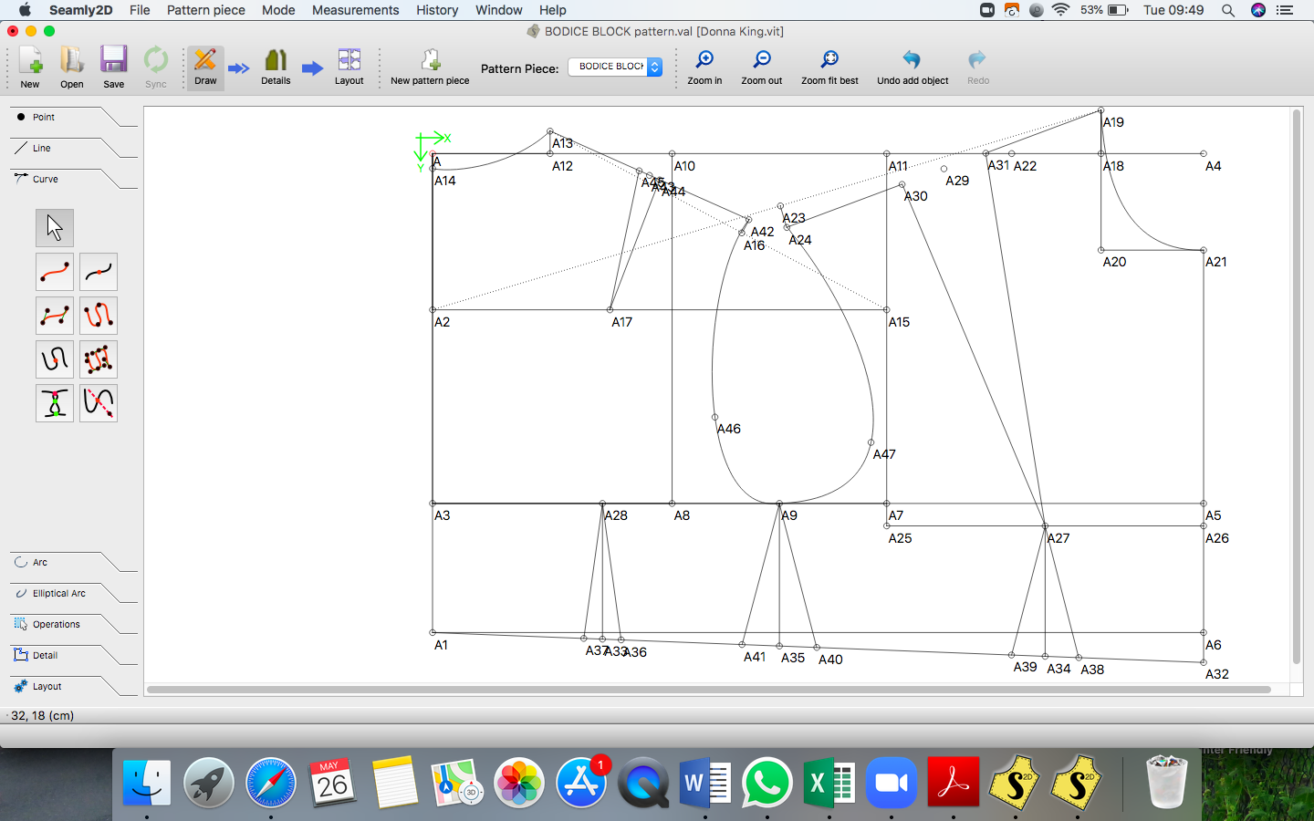

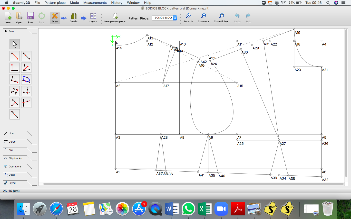

I’d like to have a passmark on each or the arm hole curves.
I can add the point by segmenting the curve as below but I can’t add the points to the detail without it looking strange.
Thanks
Curve, passmark, curve; you have to select the curve, select the mark, & select the curve again. I think that will fix the strange looks it’s giving you. If not, we might need more pictures, such as of the Workpiece Tool step. :grin:
Of course, to mark A46 as a passmark you would, in the Detail options dialog, right-click, (ctrl-click?) A46 & select Passmark. :unicorn:
Perfect…It worked. Thanks so much. I would have gone round in circles for hours.
