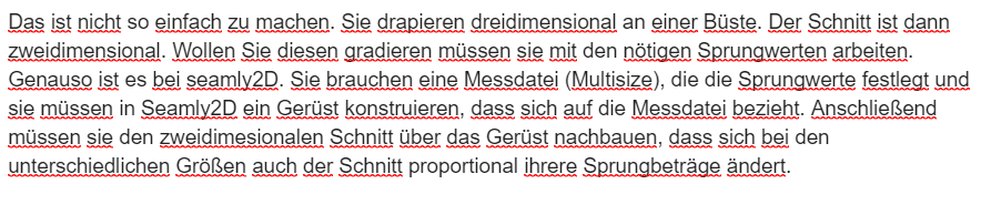

Das ist nicht so einfach zu machen. Sie drapieren dreidimensional an einer BĂŒste. Der Schnitt ist dann zweidimensional. Wollen Sie diesen gradieren mĂŒssen sie mit den nötigen Sprungwerten arbeiten. Genauso ist es bei seamly2D. Sie brauchen eine Messdatei (Multisize), die die Sprungwerte festlegt und sie mĂŒssen in Seamly2D ein GerĂŒst konstruieren, dass sich auf die Messdatei bezieht. Anschließend mĂŒssen sie den zweidimesionalen Schnitt ĂŒber das GerĂŒst nachbauen, dass sich bei den unterschiedlichen GrĂ¶ĂŸen auch der Schnitt proportional ihrere SprungbetrĂ€ge Ă€ndert.

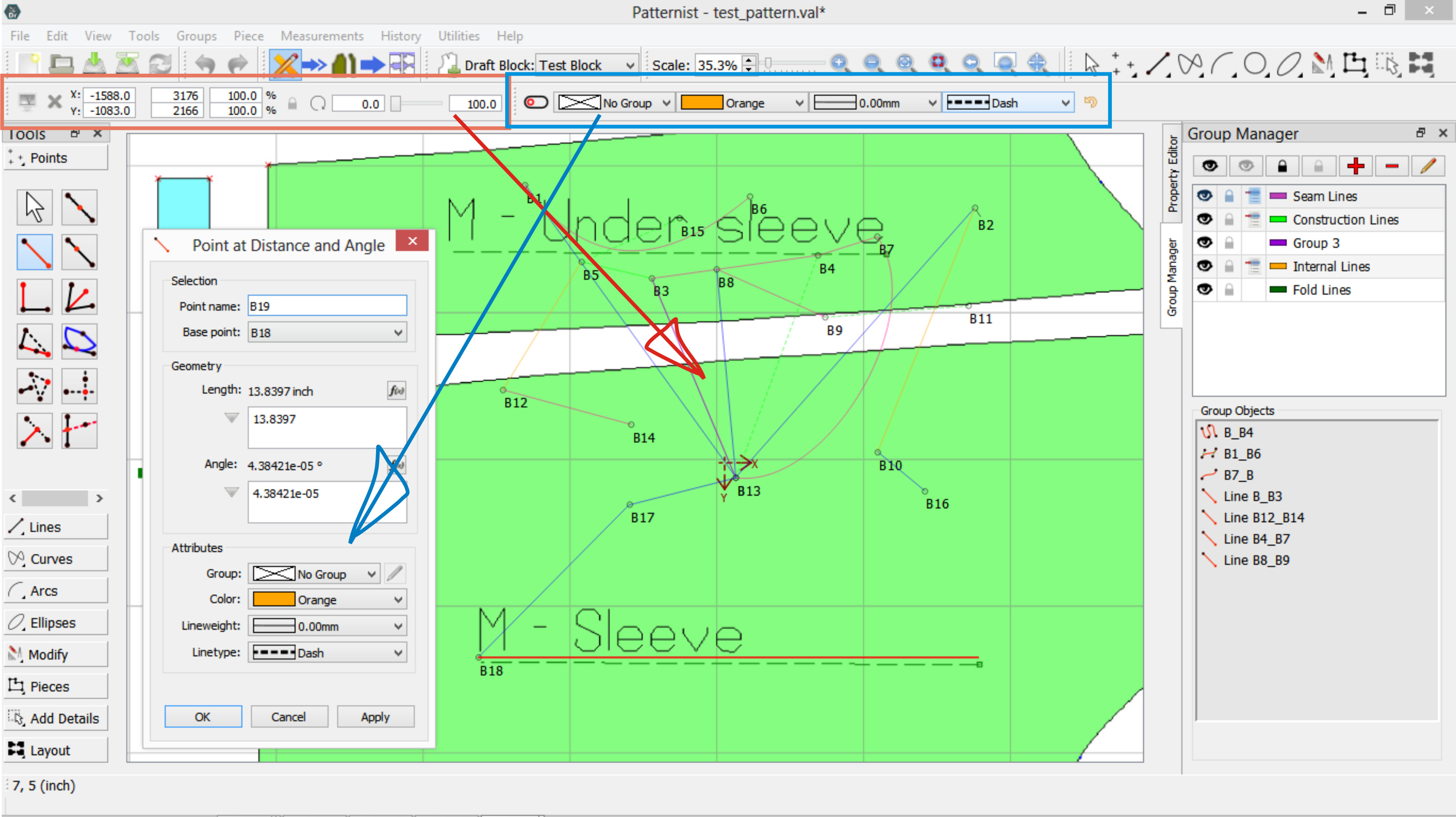

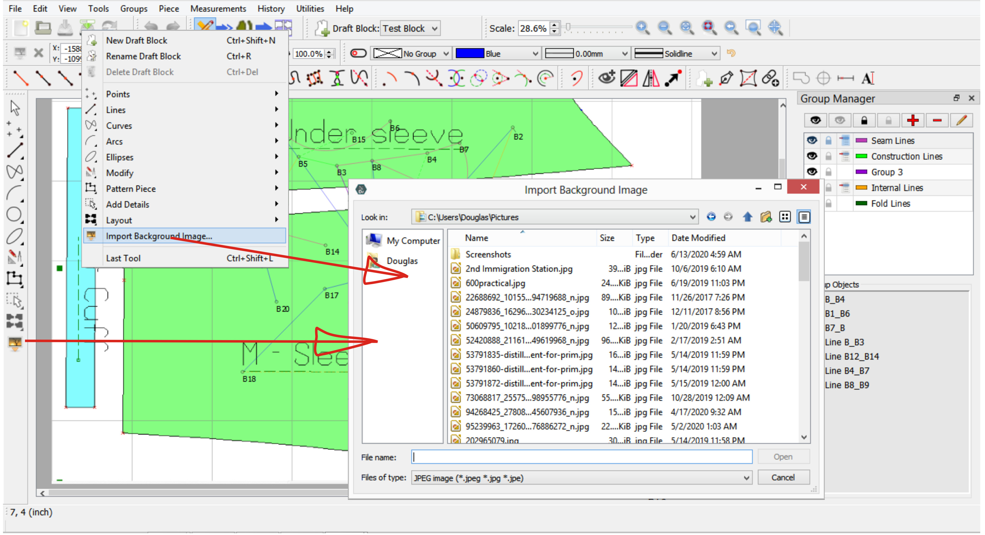

I have worked out a feature in my personal fork that allows one to load a graphic image (the usual png, jpg, gif, etc) as a background image for each draft block. It inlcudes a toolbar that allows one to scale, locate, rotate the image and set the opacity. By including a known reference measurement on the image you can scale the image to match the real size in the workspace. I’ve actually been busy at work for the 1st time in a year getting costumes for a few shows out the door. I hope to port it to Seamly 2D in the near future. BTW
 you may note in the second attached image there is also a “pen style” toolbar, which keeps track of the current pen being used, which new tools will default to so you don’t have to keep editing every new tool for line type and color. You may also notice that new tools can be assigned to a group while being created
 more on that later.
Douglas, would you be willing to share this personal fork? I’m very interested in this feature :slight_smile:
If you don’t mind waiting a couple weeks I think I can merge this feature into Seamly2D relatively quickly. It was the last thing I was working on my own fork before I jumped into working on Seamly2D so it’s a bit more polished than a lot of features - some of which are unfinished - in my own fork. Besides, I’ve have since discovered that since this feature saves the background image(s) filenames in the pattern file, I need to add code to more elegantly handle a situation where the file is not found by presenting the option to find, load a different, or ignore the background image.
4 Mi Piace

 I made it so you can load an image for each draft block - if you choose. Like I said I just need to address the issue of when an image file is not found - rather than just throwing a warning that the image can’t be loaded. Ideally it would be nice to be to search/ replace multiple images at once, rather than 1 at a time. Several of the video and audio editors I use have this approach for project media files
 where maybe you moved them to another directory, and after replacing the 1st missing file, the app tries to find the rest in the same directory. In any case I need to add the ability to find missing images, even if it just like the searching for a missing measurement file.
