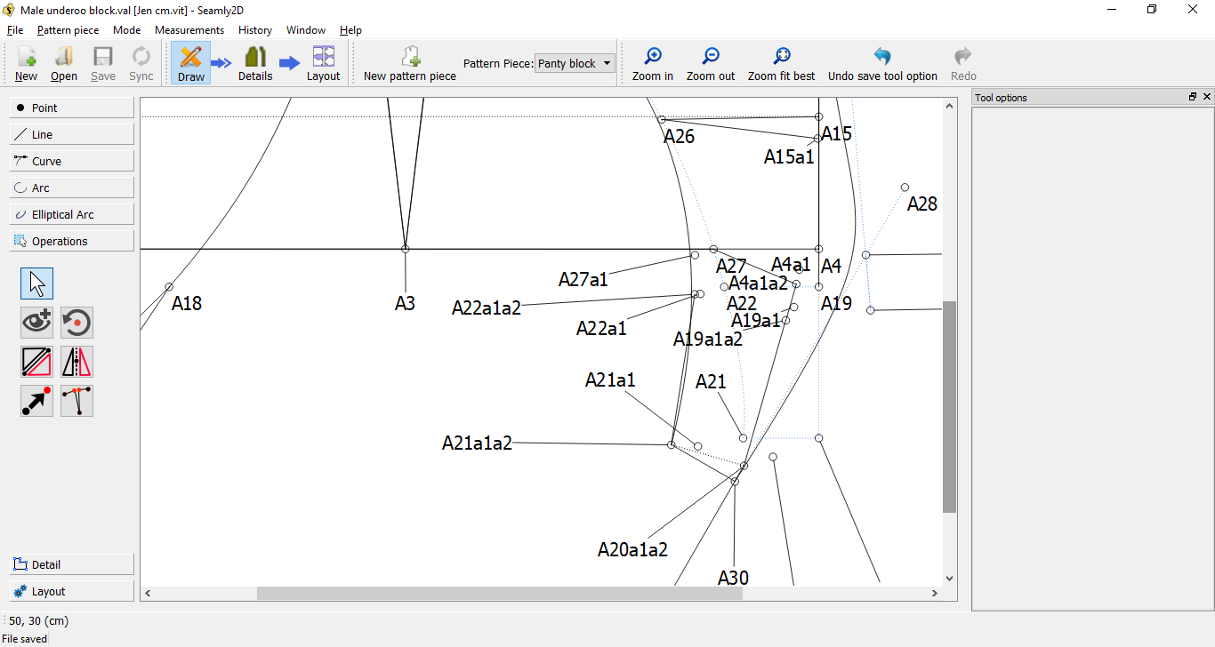

Me again! I am stuck moving this dart - I had to redo a lot of my block.
When I select the points to rotate, it doesn’t seem to be picking them up. I only get one “pink” point when the dart rotates around. I can’t figure out what I’m doing! Hopefully this link takes you to the screen recording I did. link to dropbox
Common mistake. Hold CTRL key for multiple selection. Also you can use rubber band (click left mouse button and drag).
Thank you again, that’s embarrassing! I should have gone to bed instead of trying to continue with my bodice!
Is there no way to have the piece just rotate and not leave behind the original points? I’m trying to do this method and although it technically works and I can make the line colours lighter the amount of unneeded point is kind of out of hand on this simple pattern piece.
You can group unneeded points (eye icon in ‘operations’) and make the group invisible like you would a layer in photoshop
Oh, I never got into the grouping. Thanks :slight_smile:
