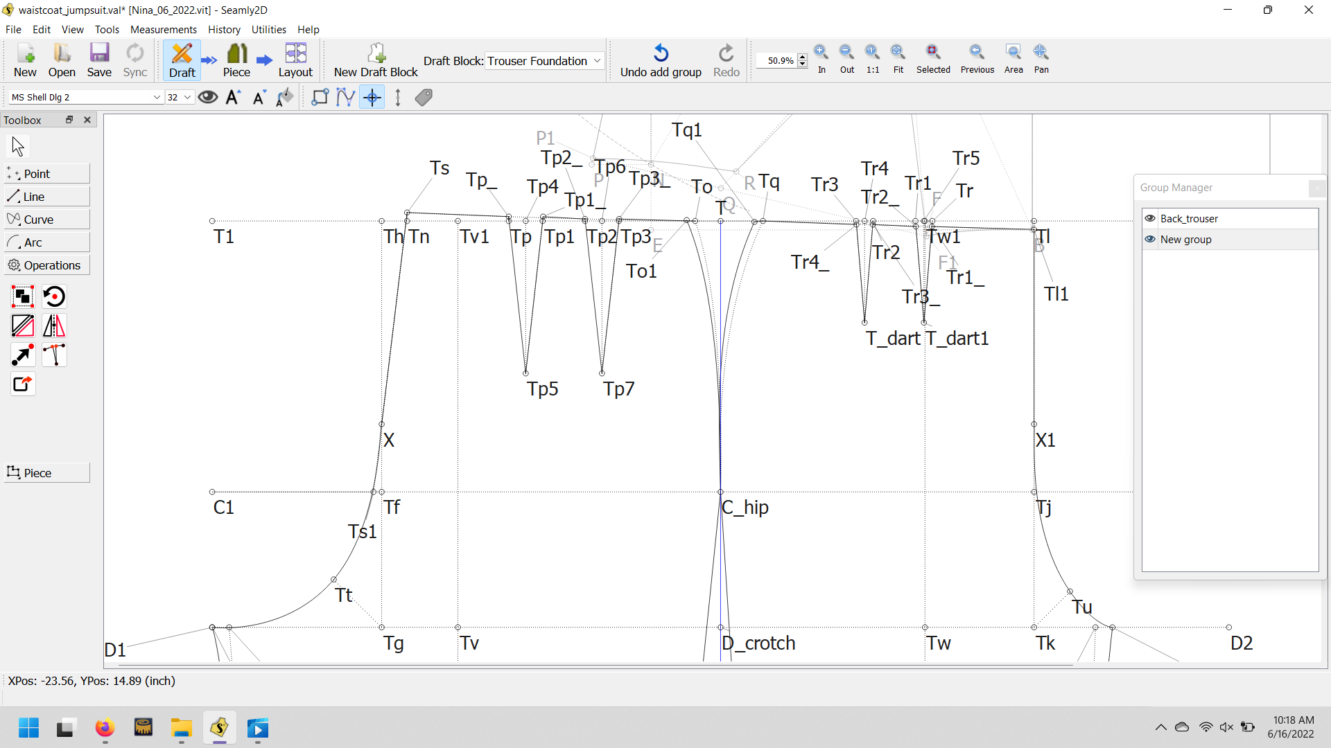

I have been making great progress with the software and am attempting to draft my first pattern, a waistcoat jumpsuit. I have drafted the basic front/back bodices and trouser blocks in the same pattern file, and am ready to work on top of the blocks.
In using the Group tool, I find it very difficult to successfully select all the elements.
I have encountered this difficulty which I can’t seem bypass. I am trying to select a shorter solid line (Ts to Tp_) which is laying on top of a dotted, longer guideline (Ts to To), and each time, the tool only selects the dotted, longer guideline. I am attempting to keep all my dotted guidelines in one group, and the simple drafted block in another group.
Relatedly, is there a plan in the future to include the ability to add elements to a group after selection? Or the ability to merge groups? That would be most helpful for my clumsy fingers.
Thank you so much for the help!
Nina
Hello @nina_theatticlier
I’d add the longer line to a temporary group if it isn’t already a part of another group and “close the eye” on that group. This will hide the line so that you can select the shorter line.
