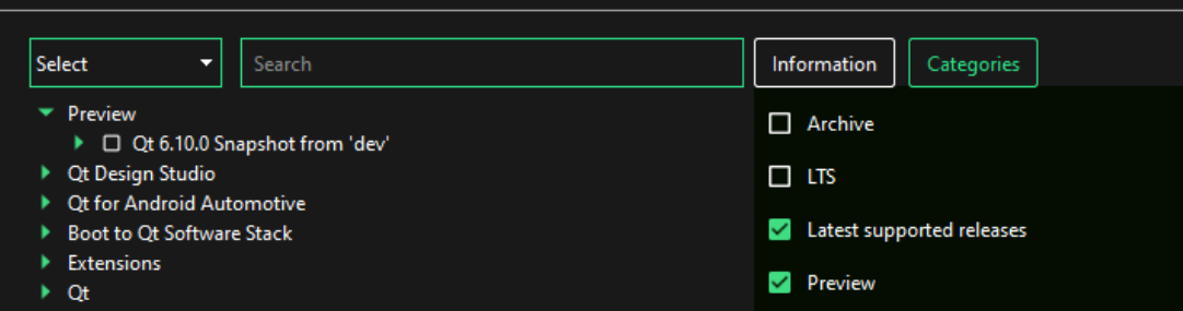

Assuming you’ve got the Qt maintence tool setup, you have to select archive or search for 5.15,2:
I totally missed the archive selector :sweat_smile: went looking in the ci pipeline for how the build containers handle it
Were you able to find the 5.15.2 Qt?
Yes, I’m trying it out now
