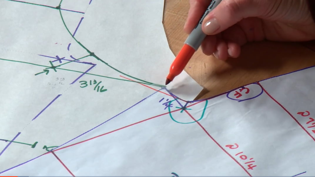

I don’t know if my question makes sense so here are some pictures to help.
Armhole Peak This is an Armhole peak before truing and the dotted line is where it needs to be cut off to get a trued armhole curve.
This is a crotch point being trued where the green side is the trouser back and the orange side is the front. The line drawn by the red marker is the where the pattern must be cut to get a trued curve.
To manually do this, you just need to align the sides of the tip and draw/cut off the peak, but is there a way to do this in Seamly 2D without manual intervention?
