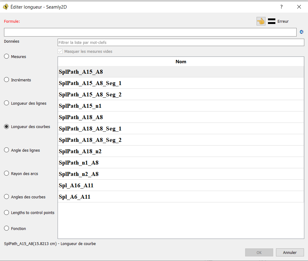

The curve length measurements can be found if you use the f(x) icon to search for Length of Curves:
Use the search field to enter one of the points on the curve to find all curves that use the point, select a curve to enter it into the formula field at the top of the popup window, click OK:

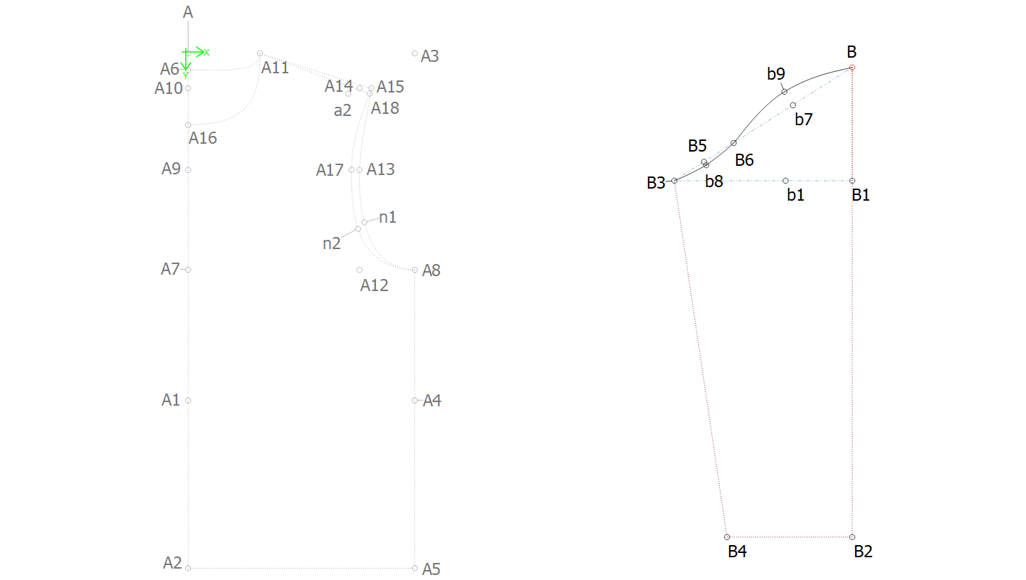

I’m sorry to say that I can’t find what I’m looking for Here’s what my flat body block looks
The B6 point on the sleeve piece is the pitch point I must report on the A15-A8 and A18-A8 curves. (named here n1 and n2) As you can see, I have only access to the curves lenghts that are on the body block and none of the curves that are on the sleeve block… That’s why I asked how to do. I suppose I’m not doing what I should…
In order to prevent the possibility of an infinite recursion, (basically software cancer proliferating in your computer’s memory,) it is not possible to use future lengths for past measurements (X=X+2.) There does appear to be a way to edit your History, (at great risk to destroying your pattern,) which @Grace seems to be familiar with, (I have yet to figure it out,) which she posted about here:
Your best bet may be to make the armscye of the bodice after making the sleeve. :unicorn:
Ok, I’ll keep to my workaround :rofl: It seems way much easier :rofl: I can’t make the body block after the sleeve block either as I need body block lenght to input in my sleeve block :crazy_face: Once you know you have to do that way, no pb, I just thought I had missed something :wink:
Hi, by hovering your cursor over the curve, you can see it’s length, then you can hard-code the length into the pattern at N1 or N2:
Another way to see the length of a curve is in the Variables Table - Menu > Measurements > Variables Table > Length of Curves:
I did it the second way you explained as it’s not the entire curve lenght that I need but a segment. So I used the measurement table to input manually the lenght I needed :wink:
