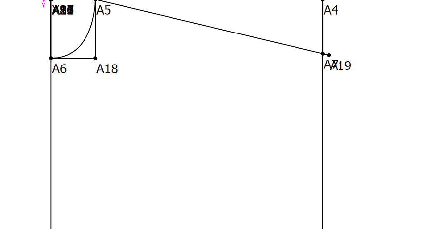

I created a curve by using Intersect XY Tool (created the node 18) and Fixed Curve Tool.
Now I can not change the nodes created after the node 18. For example the node 19.
Why? How can I do It?

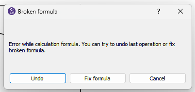

That being said… It’s generally not a good idea to rename Point names unless you know it’s not going to affect formulas down the line or you may encounter this error:
Name your points as you create them.

I assume you were trying to get point A18, but didn’t know the order of points selected determines which side of the curve the XY point is on. Think in terms of walking down the curve path… the XY point is going to be created on your left hand side. From A6 to A5 it’s going to be A1 and all those other points… from A5 to A6 it’s going to be A18.
Sorry, you are right.
I can change the name.
I didn’t see there are a lot of nodes created by mistake there.
