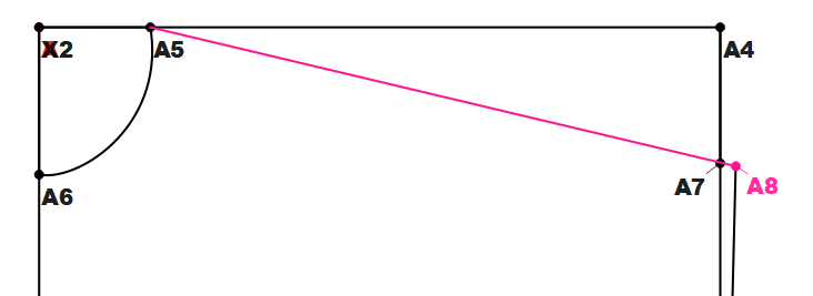

I can not delete the line between A5, A7, T-Shirt Pattern 2.sm2d (4.5 KB) A8
I created this node with the Point Tool No 1.
How can I delete this??

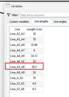

There is no line between A5 and A7… the line is between A5 and A8:

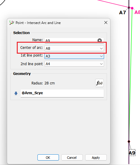

And you can’t delete Point A8 that creates LIne_A5_A8 for several reasons.
  1. Point A9 uses points A8.

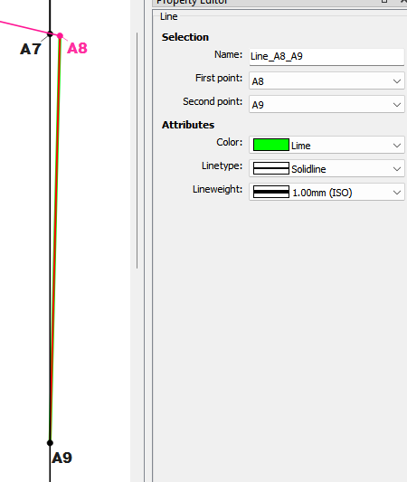

  1. Line_A8_A9 also depends on point A8.
  1. Points A8 and A9 are used in the pattern piece.
