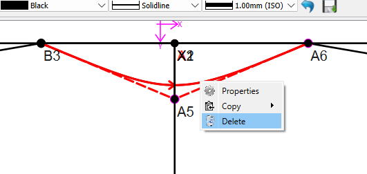

I can not delete the curve between B3-A5-A6 the Delete Button is unclickable.
I can not delete the node A5. (to delete the curve) It gives Parse error and the pattern goes weird. How can I delete the curve?

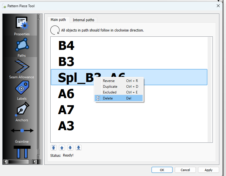

As explained by the warning popup, you cannot delete the curve because it has children, that is to say that you created elements in your pattern that are based on the curve you’re trying to delete:
Indeed, you created a pattern piece in which there is the curve:
In order to delete the curve:
First remove it from the pattern piece (or remove the pattern piece):
Then you can remove the curve:

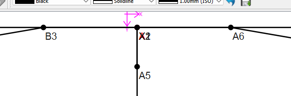

The files without the curve:
Kimono A.sm2d (5,1 Ko)
Kimono A.smis (844 Octets)
I could delete the regarding curve at the piece mode.

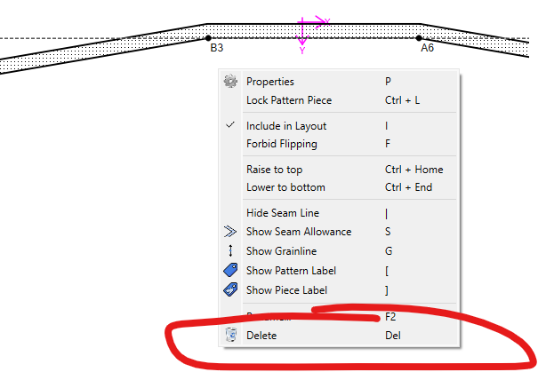

Now I want to learn how to delete the piece completely. How can we do this?
Evans
June 15, 2025, 9:58pm
5
You’re welcome.
Right click → delete, or just hit the del key after clicking on the pattern piece
Ok. I didn’t see this.
I tried to delete It from the Right Panel in Piece Mode.
Thanks for the answers.
