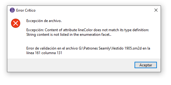

@Gonzalo_Jimenez Is it this error: “file error exception:Content of attribute lineWeight does not match its type definition: String content is not listed in the enumeration facet”

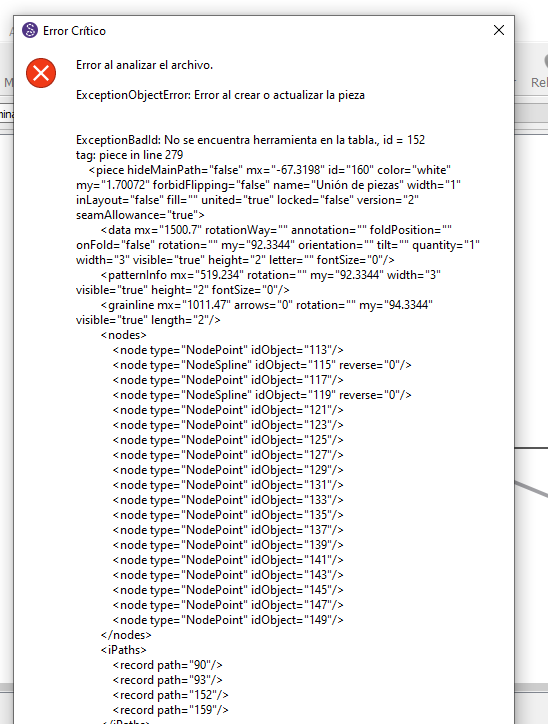

Sure! This are the two errors I’ve been getting.
This one says something about line 161 column 131, I’m assuming it refers to the “programming” of the file? And this is the second one. Even if the files couldn’t be repaired, I’d love to know if there’s any way to avoid that happening. Now, when I make a new pattern, I try not to delete any point/line/curve on the pattern and rather hiding it inside a group, I don’t know if that could help? Anyway, thank you so much for your time!I sent you your fixed file back via PM. The pattern files are pretty forgiving and we can usualy fix them without losing much is anything at all. In this case it was my bad as when I updated the internal paths recently I used the incorrect strings of “Black” instead of"black" and “1.00” instead of “1” for the default data value. That’s why was throwing the execption for the lineColor on line 161. The color part was fixed with last monday’s release, but I didn’t realize the lineWeight has an issue too. Until I fix the line weight I suggest use a different color & line weight other than Black and 1.00 so the internal path don’t use the bad default values.
