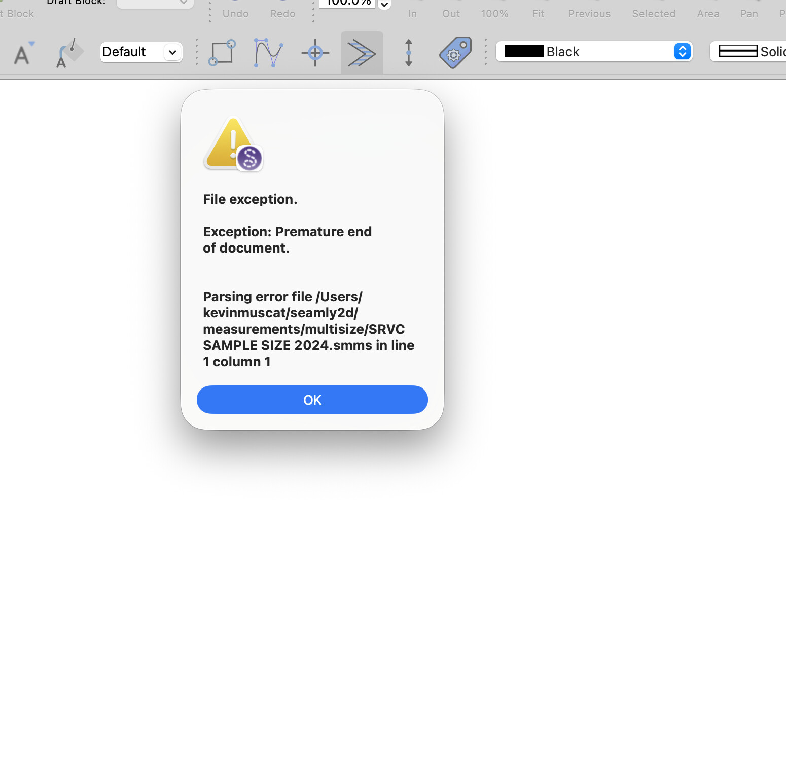

I can't open any of my files
I am getting this message when I try to open my files. It only just started happening now.

I hope you have backups, because it looks like something ate your measurement file. How were you using it? So far this appears to happen when users have multiple files accessing measurement files in one session. Hence the warning at the top of the sceen here on the forum. But if you can shed additional light on the issue, the devs would be grateful for any clues that might help them fix the issue.
If you still have the file open in Me, you can save it to restore the file.

I hope you have a copy of your measurement file on the laptop because I think this one could be totally blank. If it isn’t blank, then there will be a number of blank lines between the data lines which will need to be removed in a text editor.
If you upload your measurement file here, someone will have a look and repair it for you (if they can).

Always a good idea to backup everything… that being said I have a fix for the issue, and I would expect it to be in this weekend’s release. It won’t be a problem with the fix opening multiple patterns with the same measurement file.
I have made a PR and just waiting for Sue to review and approve.
