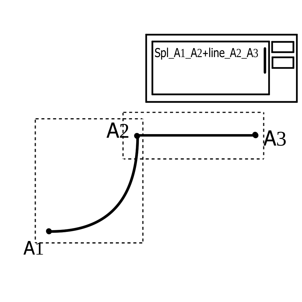

Hello! :slight_smile: Yesterday I posted about my struggels while building terms and referring to objects. Mostly the amount of writing and the (admittingly small) hussle of finding the name of an object. Because changing the naming of object is something quite difficult (thank you @Grace ) for your answer) I came up with a smaller idea that could potentially make this step easier.
When hovering on an selected object, their properties get displayed, and so does its name. The idea is, that when an object is selected, and we “ctrl+c”, the name of that object gets copied. And if multiple objects get selected those could be joined with a “+”. Maybe if we press “shift” in addition, the degree of that objects gets copied instead, since you rarely need both degree and lenght in one term.
If we want to take this even further I could imagine an additional window in the/next to the “f(x)” button/window, where we get taken to a builder that displays the copied objects and lets us work with them simultaniously.
In addition,when the name of an object in the term manager gets selected, the object it referres to gets highlighted in some sort.
Maybe this is a better way to make termbuilding more efficient. Please tell me what you think of that!
