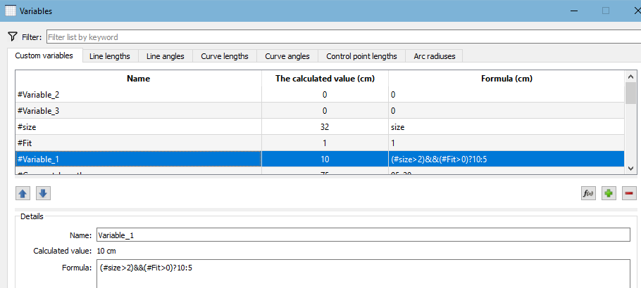

The functions is Seamly2D are powered by muParser. You will find a list of the functions here and how to use them.
According to the muParser, the ampersand (&) is the character to use for the AND. Here I’ve tested the AND condition:
The formula is: (#size>2)&&(#Fit>0)?10:5
I hope that this helps you.
Douglas
22 november 2024 om 07:39
3
@MG2024
Just to add to that… the logical “operators” follow the C++ syntax, where Equal uses ==, AND uses &&, OR uses ||, etc. Common mistake is forgetting and using just one =, | or & and it changes the operation. I’d be lying if I said I’ve never done that in the app code… fortunately the compiler will flag such an error when building the apps.

Perfect, thanks it works.
