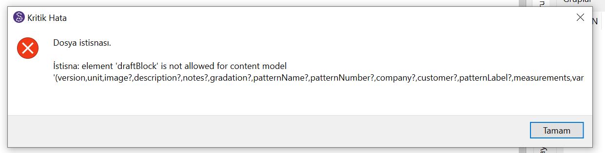

I'm getting an error when opening the file
I’m getting an error when opening the file!!
If you would upload the pertinent files (.smis/.smms, .sm2d) we’ll have a look to figure out what is causing the issue.

Because I’m a new user, it’s not allowing me to upload anything, and yes, I’m from Türkiye.

It sounds like the issue where the top part of the file is moved to bottom, where the draftblock tags are messed up. I’d have to see the file to know for sure. Also if would be handy if I can see a screencap of the error message.

This should be repaired, it does appear to be what @Douglas thought. as you didn’t send the .smis, I cannot test it, but it’s giving me a “smis not found” notification instead of a “draftblock not allowed” ss26ilkbaharorganezekahveetek38-fix.sm2d (22.2 KB)

Ah… you beat me to it. :slightly_smiling_face: This one was odd as the cut section ended up in the middle of the file instead at the end like it usually has been.
We just had long discussion in today’s meeting on this issue, as well as a couple others over the past few weeks… and it’s my opinion that these mangling of the patterns files could be the result of using OneDrive. That’s why I’m curious to see the error message and whether it displays the path of the pattern file, and whether the path includes OneDrive.
Maybe @ezgi you could let me know if your pattern file(s) are indeed stored on OneDrive? OneDrive seems to have serious sync issues and corruption of files. Something I’ve been immune to since I have OneDrive turned off.
