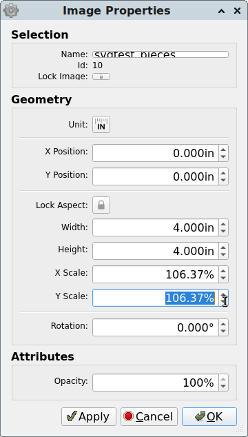

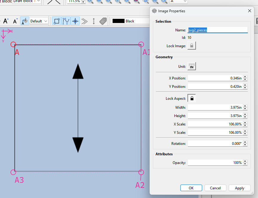

I tried it with a layout svg I have. The file had been edited in Inkscape. It was smaller than the draft. Looking at the svg in my text editor, I see that it’s supposed to be 14" by 8.5", & remember that I was printing it to Legal size paper. It’s a doll-size layout. Setting the size to 14" by 8.5" in the Image Properties dialog gets it fitting at 106.67 magnification.

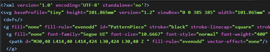

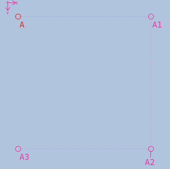

OK… I played a little bit while watching football… I made a 4in x 4in square, made piece with no SA, and exported it to SVG.
Here’s what it output:
Note that the width and height are 101.865mm close enough to 4in (101.6..). Also note that the path rect in pixel size is 384 x 384… again close enough to 385px x 385px.
I then imported the SVG…

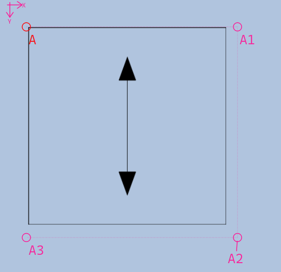

clearly smaller by about .94% … scaling to 106.67% (aligning with @Pneumarian) it then fits perfectly:
So that would indicate something amiss in the svg render when importing.

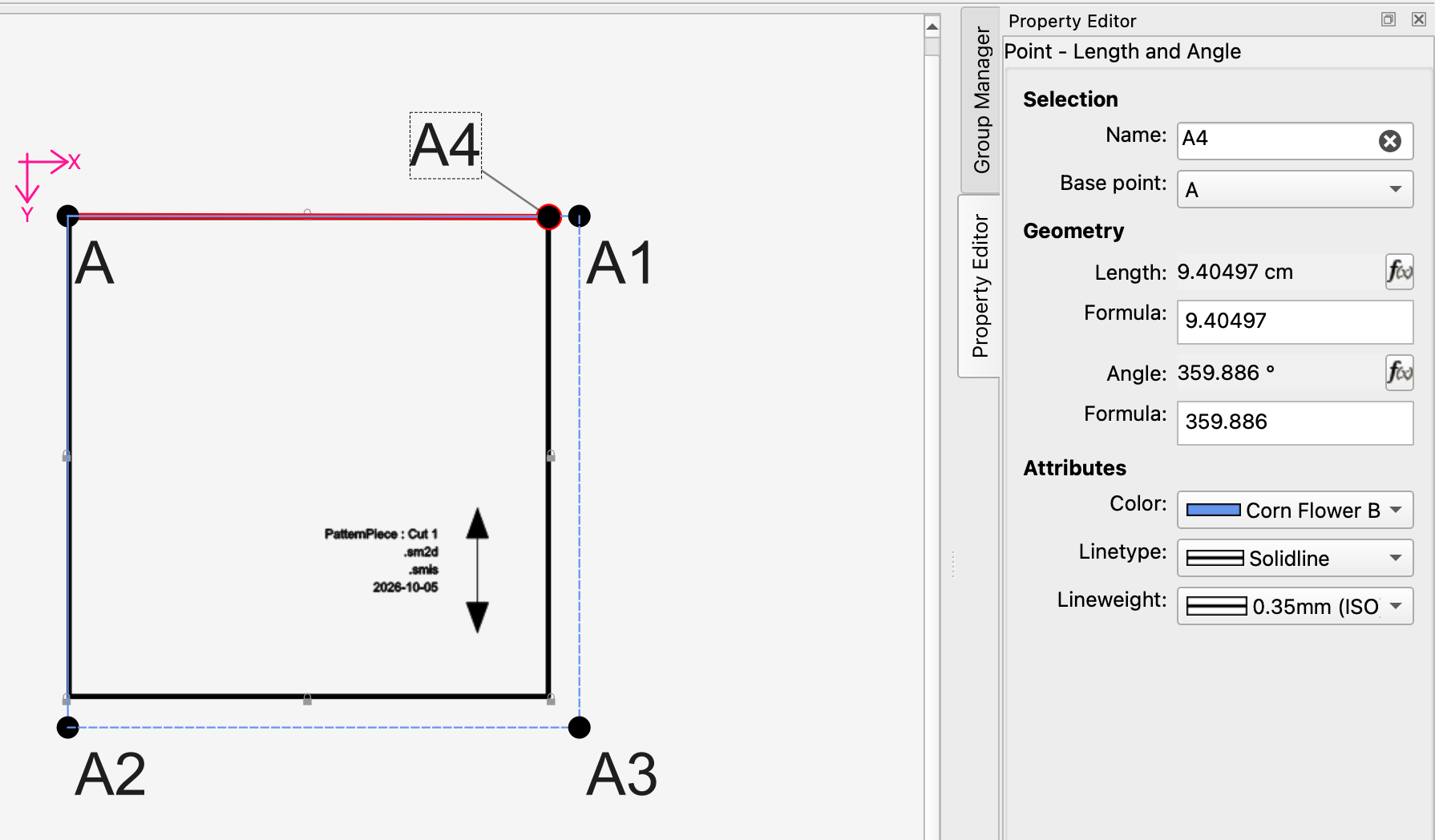

I’m using macOS Ventura 13. It seems I’m getting .94%.
I drafted 10 cm square and exported in Piece mode.

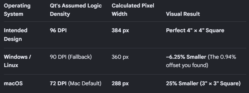

I just tested a fix on Windows and it scales perfecftly now. The fact you are also scaling at .94% means Qt is bypassing the macOS fallback 72dpi and is hardcoded to 90dpi.
And the Qt docs would confirm this:
QSvgRenderer::defaultSize() reads the width and height attributes. If the units are cm, in, or mm, they are multiplied by an appropriate value to give pixels at a resolution of exactly 90 DPI. For example, mm is multiplied by 90 / 25.4.

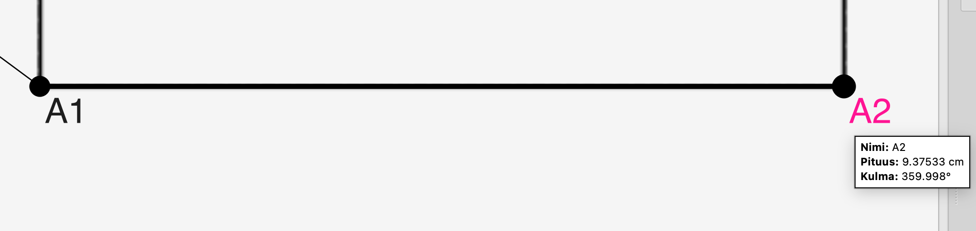

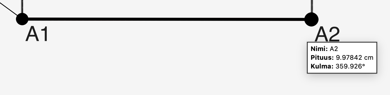

I tested the artifact build and compared it against this mornings official build. I used same imported SVG on both tests. With Mac (macOS 27).
First screenshot is from today’s official download and the second screenshot is from artifact one. My imported reference image had 10cmx10cm square. I eyeballed line there but it seems to be more accurate in artifact build (9.37533cm vs. 9.97842cm)
Thanks @03Pencil … saves me time testing the macOS build. :slight_smile:
Well that confirms the fix works on macOS
9.37533 / 9.97842 = 0.939581 ~ .94%
Or basically taking rounding error into account:
9.4 / 10.0 = .94%
0r
90 / 96 = 0,9375 ~ .94%

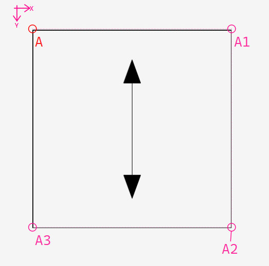

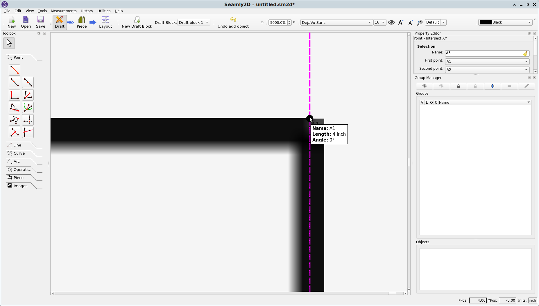

I just made 4 x 4square, made pattern and exported SVG, and imported it back in. This way it checks the horz and vert scaling.
@Douglas Still off:
My bad… I should have said to try the artifact of the still pending PR… :roll_eyes:
I should have realised that I was missing something!
As you can see, it’s now 1 hundredth of an inch large when importing the 4" square I exported yesterday. (The Properties says so.) I assume this is because the actual measurement of the export is down the center-line. An 18" square was also off by the exact same hundredth of an inch.
Yes… I believe the actual measurement is down the center.
In either case 1/100" is close enough. :slight_smile: It’s also is an example of where precision gets more important the smaller you get.
