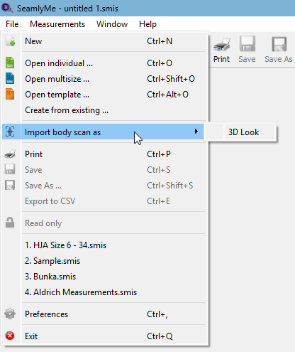

Hi @Sue , I have tried the 3DLook and it seems to work quite fine. However, I got interested in the 3D Measure Up after reading your comment about it. However, it seems to me that, unlike 3D Look, you actually have to upload your own 3D scan to their system to get the measures. Did I get that right or do they have a phone app to get the measures and make the whole process smoother? If not, What 3D scanner would you use? I am trying to find the best and most practical solution for extracting the most accurate measures and was abolut to commit to 3D Look, before seeing this topic here. Kindest regards, Sami
Hi @samitapani , sorry for butting in here. However, I believe that 3DLook also takes measurements from a front and side photo taken with your phone. These can be exported from 3DLook and imported into SeamlyME. If you’re still on the trial, you can check this out before making a decision.
Hi Grace and thank you for your input! I did try 3D Look for 2 weeks and I really liked it. It has a phone app that takes 2 picures of the subject and produces a list of 80+ measurements and an avatar as an OBJ. However, the measurements that it gives you don’t obviously translate directly to SeamlyMe, but you have to send them to Seamly to be converted. Unfortunately, I haven’t received any converted files from Seamly that would have opend in my SeamlyMe. I have sent a support request, but haven’t heard back as of yet. That is why I was so curious about the 3D Measure Up and if someone has experiences with it.

Have you tried importing them directly into SeamlyME?

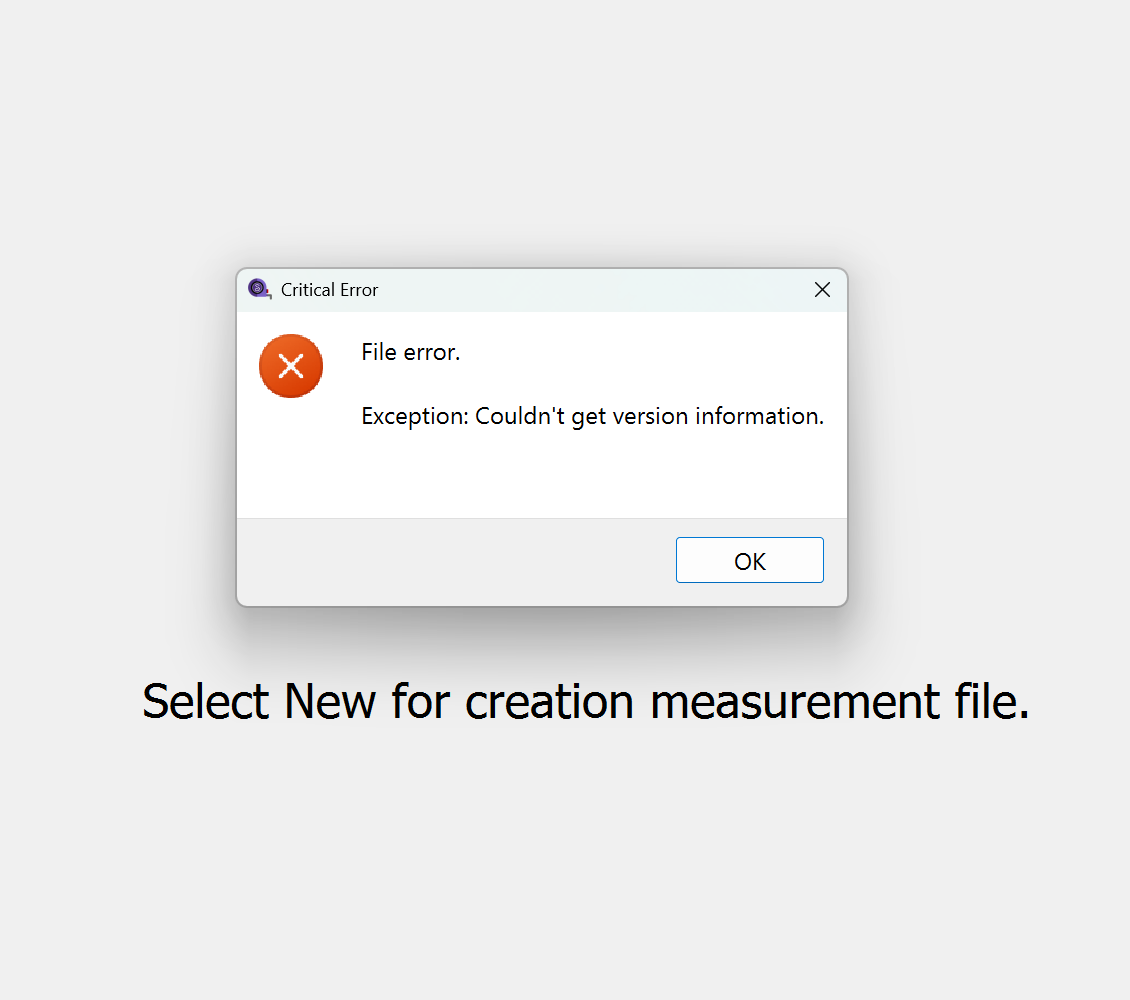

Oh sorry, I think my answer was a bit confusing. I meant that I DID receive converted files back almost immediately, but they don’t work with my SeamlyMe. I can’t open them.
Maybe this would work?
Viewing the file in a txt editor, just after <!--Measurements created with SeamlyMe v2024.5.27.150 (https://seamly.io/).--> on the next line there should be version information <version>0.3.4</version> You could try seeing if that would work, or sending a copy over so that someone else can look into it.
I hope this gets you in the right direction.
Hi @Pneumarian ! Thank you for the suggestions. I changed the file, but unfortunately it didn’t change the outcome. I have sent the files in question to Seamly support, but haven’t heard back from them yet. If you are interested in taking a look at the SeamlyMe txt file, here it is:
SeamlyMe.txt (5.0 KB)
I changed the capital Version to lowercase version, & now I’m getting a different error:
File error.
Exception: Element pm-system is not defined in this scope.
Edit: AH! it should be pm_system not pm-system & birthdate needs an entry.
@samitapani It should work now (it did for me): samitapani.smis (5.1 KB)
