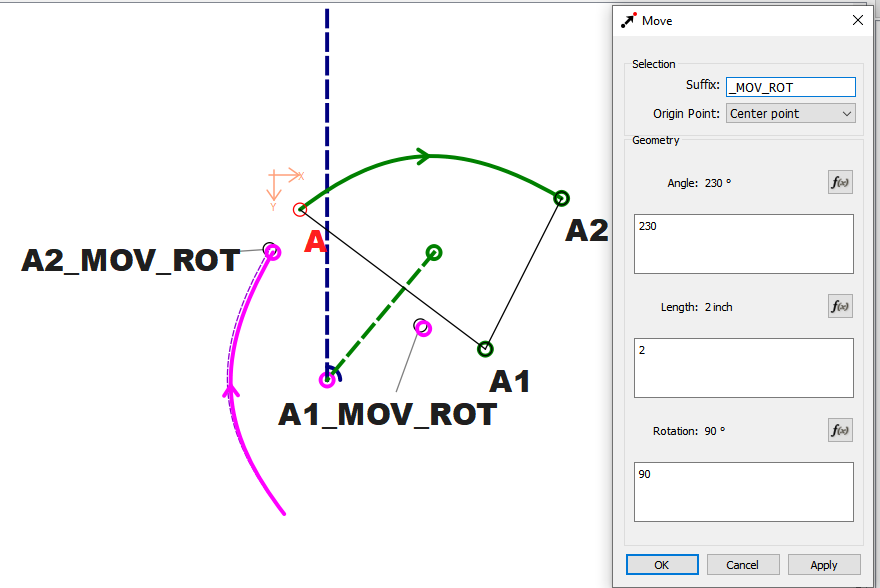

What I’ve got so far fit’s the title, but not necessarily the discussion of the issue. Added is the ability to rotate a group of selected objects after moving them. Also you can select an origin point for rotation - which defaults to the center (point) of the group of objects.
Either I can keep the Move tool like this, add a union option to it, or (more likely) create a separate new tool as Grace describes in the issue discussion - using this as a starting point. As it is now this would at least eliminate some of the intermediary clutter if one needs to move & rotate a group of objects. I’ve also put in place some of the structure to set the pen style (color, linetype, linewidth) of the Moved objects… which will also apply to the other operation tools, as they all share the same base abstract class.

I figured you would like this. I just need to track down a slight glitch - there’s a discrepancy between the location of the visual (magenta) and the actual destination objects (purple dash). Probably something stupid like some clipping or rounding of some decimal points.

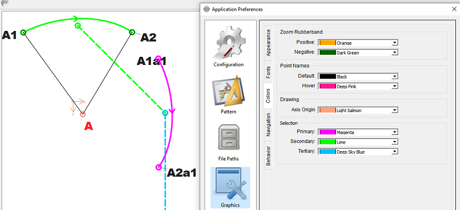

While trying to figure out the discrepancy between the ToolMove objects and the visuals, I figured I’d add some prefs for the “support” colors in the operations tools visualizations… which over time I will add to the rest of the tools. This will allow a user to change the colors if they don’t like the defaults… which are Magenta, Dark Green, and Dark Blue. BTW… the Move & Rotate needed a 3rd support color. Won’t bother you’all with the details, but in adding the comboboxes for the support colors I had to work around a slight issue with my custom “line color” combobox widget used. You might notice that a tool line can not be magenta as that’s been reserved for the primary support color. Without having to add magenta to the schema I realized I didn’t have to as we’re only storing it in the settings. Light bulb moment… I have some other ideas. :slight_smile: OR maybe I could add a separate support color combobox widget that is populated with non line colors so as to avoid any clashes? Given how many Qt & SVG colors there are there’s a lot to choose from.
That being said… after pouring over ToolMove and VisToolMove and a couple abstracts for hours, then putting it aside to add the Prefs - it worked! Sort of… while zooming in and out I noticed sometimes the tool and visual lined up (like in the attached pic) , other times not. Turns out it looks to be related to the zoom when zoomed more than 100%, where the visuals of the selected objects seem to be scaling a bit larger than the original tool objects - thus they don’t line up. This only happens when using the default “center” origin, as it’s calculated in a function by the bounding box of the objects, and since the visual is scaling different than the tool, the 2 rotational origins are calculated differently. Now I know what to look for. :slight_smile:

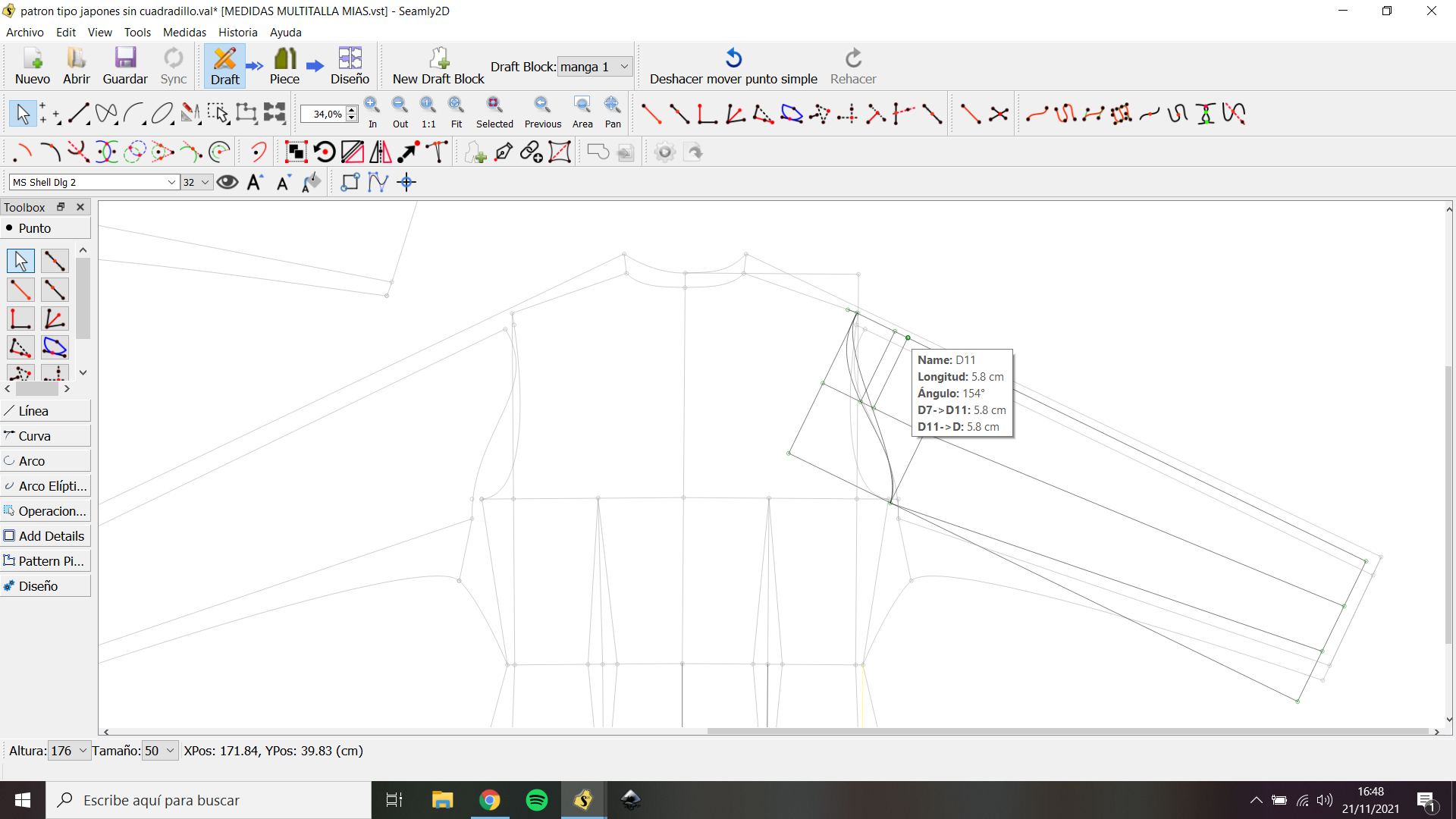

Hola Douglas lo que comentas de rotación se podrá utilizar con un bloque de patrón. De manera que se pueda rotar toda una manga y asi sobreponerla sobre un punto de un delantero?? como mi patrón. Esta manga que os enseño la dibuje inclinada, para poder cuadrarla con el delantero y así poder copiarla en el delantero.
Gracias Pilar :grinning:

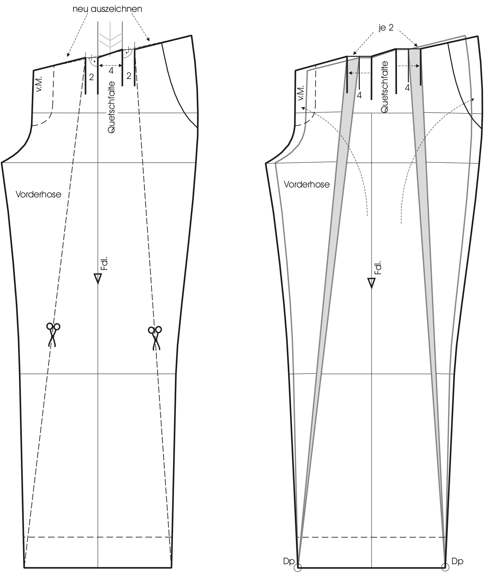

I’m still new, as you saw in my other post, but am I understanding correctly that you could use this function to ‘cut and rotate’ in a pattern?
I ask because I’m looking at a simple way to add pleats to a (non-pleated) front pattern of trousers as shown in this picture.
If I’m getting you wrong, sorry :slight_smile: Still getting to know the software.
No, this is called the ‘Slash & Spread’ method. You will need to use the Rotate tool to do this.
Thanks again grace! :slight_smile:
Like Grace said you can achieve this with just the Rotate tool… although in the example you’ve shown it’s already got 2 pleats… and it’s doubling each of those. In other words you could take a regular pants pattern… rotate once to get the 1st 2 pleats, then repeat. Note that to create an actual pattern piece you don’t need the lines connecting the pleats at the waist line, you can use the line tool to visually connect the gaps.

I tweaked my custom color combobox widget to add a method to set the list items… in a nutshell it means I can drag & drop and promote a combobox in a dialog form and then (re)set the list of color items in the drop down list. The default is the list of line colors… but now I’ve added a separate list of “support colors” to use in the prefs., where the list of SVG colors do not conflict with any of the line colors. Again we can do this because it’s a user preference and is not stored in the pattern and doesn’t affect the pattern XML schema. Here’s the colors I’ve selected… if anyone wants a color not on the support list and is not a line color I can easily add it. BTW… Forest Green and Navy are the closest to the Dark Green and Dark Blue currently used for the secondary and tertiary support colors. I’ll set these as the default.The primary will remain magenta.
supportcolors
I’m debating whether to make the 3 pref color selections exclusive as for ex: it wouldn’t make as much sense to set all 3 to magenta.
