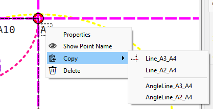

    Point - Intersect XY:

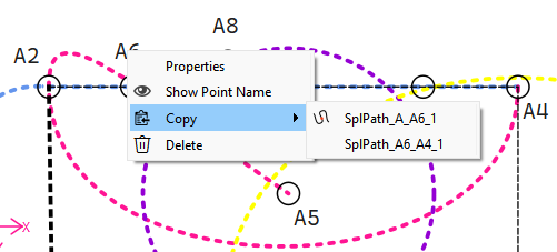

    Point On Spline… displays the 2 segment lengths:

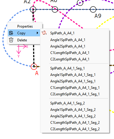

    Spline - Interactive… displays Spline Length, Length and hangle Lengths & Angles for each segment:

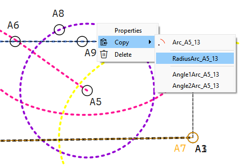

    Arc - Radius and Angles:

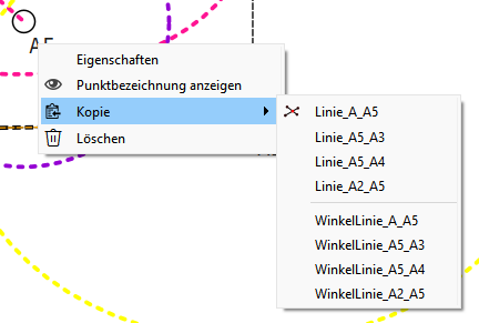

  • lupdate so variable names are translated:
