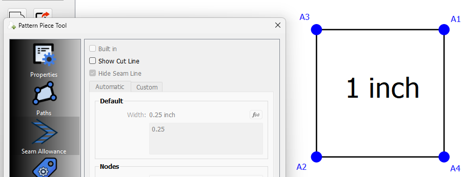

I opened your file and exported my own PDF and SVG files to check your pattern and I noticed that you have the seam line hidden, so I made it visible and exported my own PDF and SVG files. The PDF does give the 1 inch square perfectly:
I opened the SVG in Illustrator and also found that the it exactly measured 1 inch between the seam lines:
I suggest that you also turn on the visiblity of the seam lines and then check your measurements. I see that you have a quarter inch seam allowance which will affect the measurement and make the 1" seem to be 1.5", which accounts for the ‘50% too large’. :slightly_smiling_face:

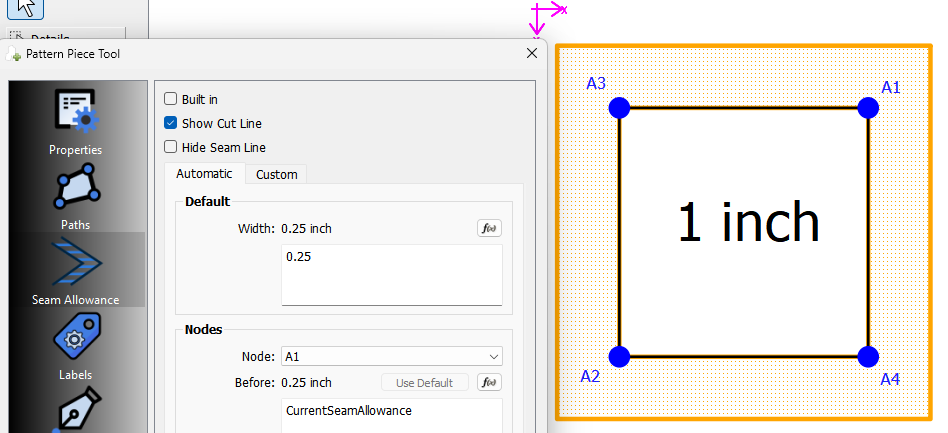

Let me help explain the checkboxes… The black “Seam line” is the path that is the path you drew, and added as a Pattern piece. The orange “Cut line” is the path that is the seam line plus the seam allowance. Note the Seam line is not hidden.
In your case you hid the seam line, but are showing the cut line… 1 inch sqaure + .25" SA.

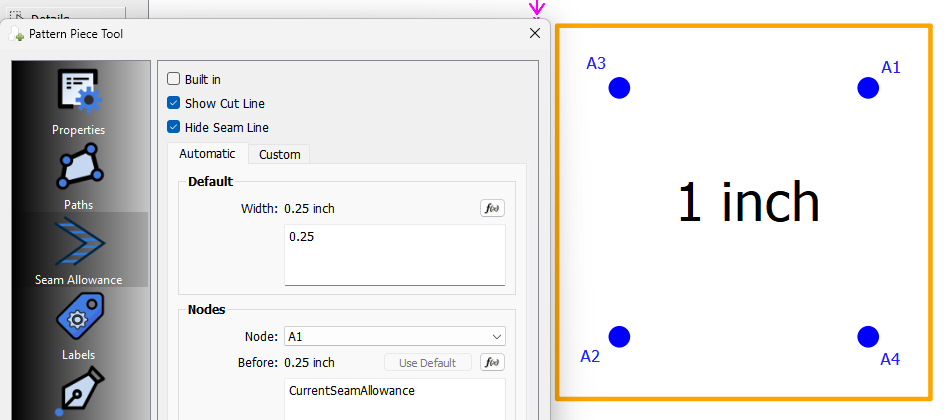

What you could do is hide the Seam line and show the cut line… so now the SA and cutline are not added to the layout piece. Other options are to use a Zero SA OR to Check the “Built in” box which will indicate that the piece was drafted with the SA included.
2 polubienia
@Douglas Thank you for the illustration, it is helpful. I had success with showing the cut line and setting seam allowances to zero.
