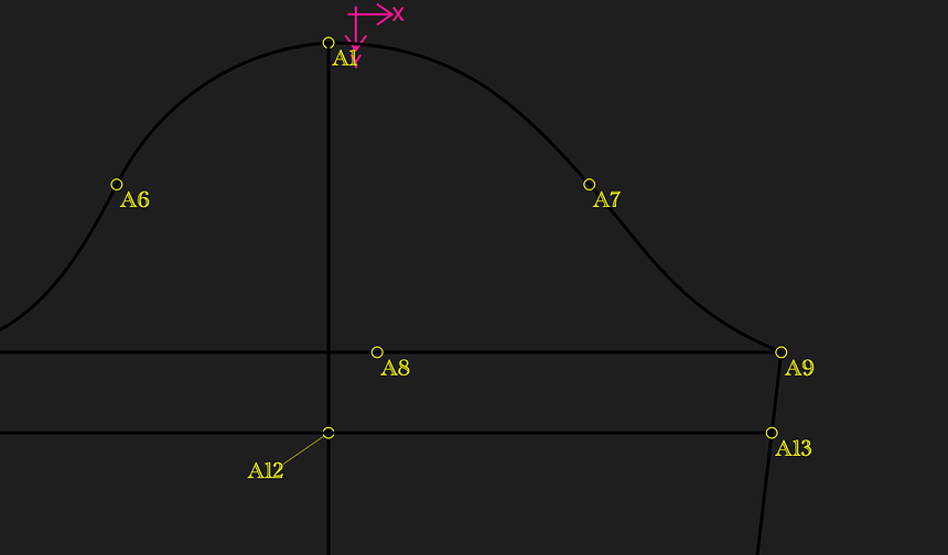

Attached is a screenshot from my seamly sleeve pattern (apologies for the black background it is not in my control). I am surely not the only one who has ever had to adjust a sleeve cap curve to match the length of an armscye and I would like to do it in the most professional way possible.
My point A9 determines sleeve cap width and the length of the back notch curve (Spl_A1_A9) is dependant on it. Its origin point is A8 which is at the same Y coordinate, which is by design so that I full control over the position of the point.
Is there a way to set the length of Line_A8_A9 (value X from the title) to be such (or to increase until) Spl_A1_A9 (Y) is a given value (the length of the scye of the back bodice pattern).

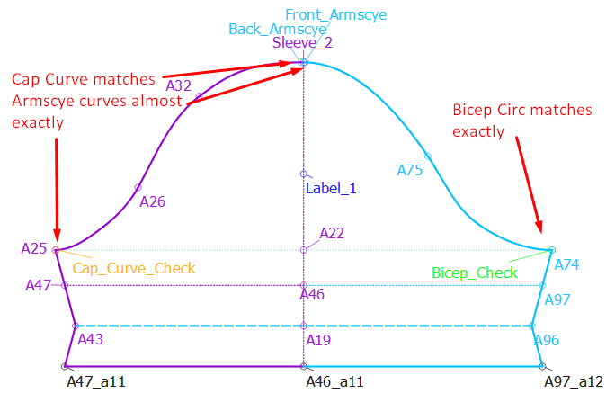

I’m busy with my own theories again :rofl: And this is what I have so far (unfortunately, I can’t check it over sizes since it’s in inches):

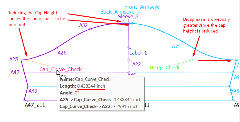

With a reduced cap height:
At least my formula’s do maintain a smooth cap curve :smile:
1st sleeve being more your typical sleeve, 2nd being more a t-shirt with little cap. Eventually you would hit the limit where A25 to A74 = Armscye length with no cap… i.e. a rectangular or trapazoidal sleeve - like a kimono.
